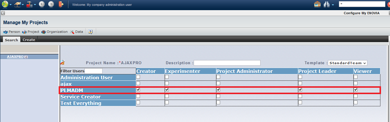

hey i have a problem to import could you help me please?
i arrive to connect correctly on catia V6 with my new user darche_j
and i have active in enovia the command import and export that's i use in catia
but now when i want propagate or import i see this message:
"error during save"
Erreur pendant la sauvegarde.
status: Error INFRA_0304
Erreur pendant la tentative de sauvegarde des données importées.
Incident système lié au serveur.
(Informations à signaler au support : java.lang.Exception: Message: policy 'VPLM_MappingModeler' does not exist Severity:3 ErrorCode:1500178)

Hey Darche,
Even i had got the same problem ,
Its just bez of multiple accounts ,
give all right to a single account as shown in fig below using your localhost Enovia v6 Host
And see the problem vanish
