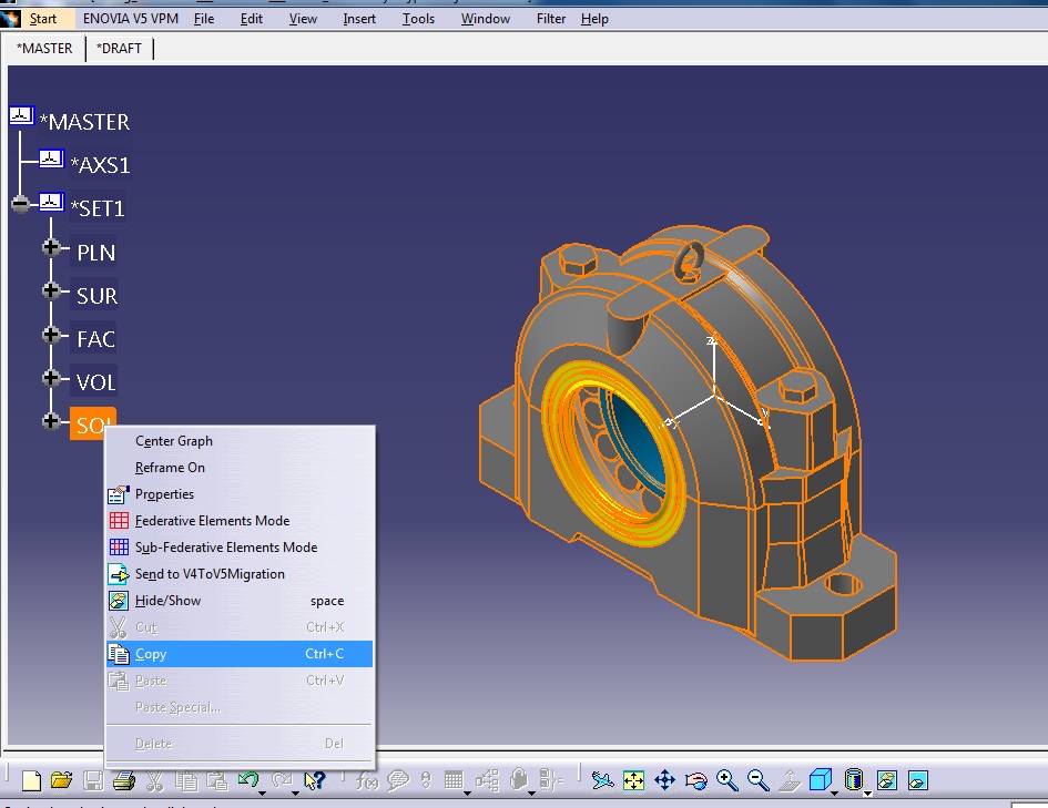

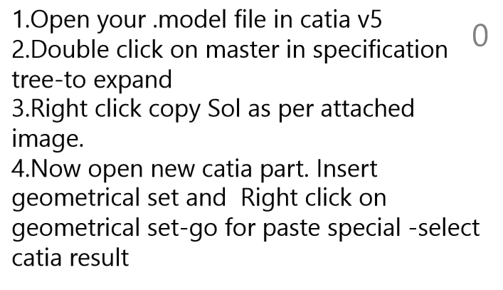

Follow as per the attached image.
Do i need a V4 license in order to do that. Whenever i try to open the model a window pops up saying no V4 license given.
would you be so kind to upload your V5 file? That would be great.
