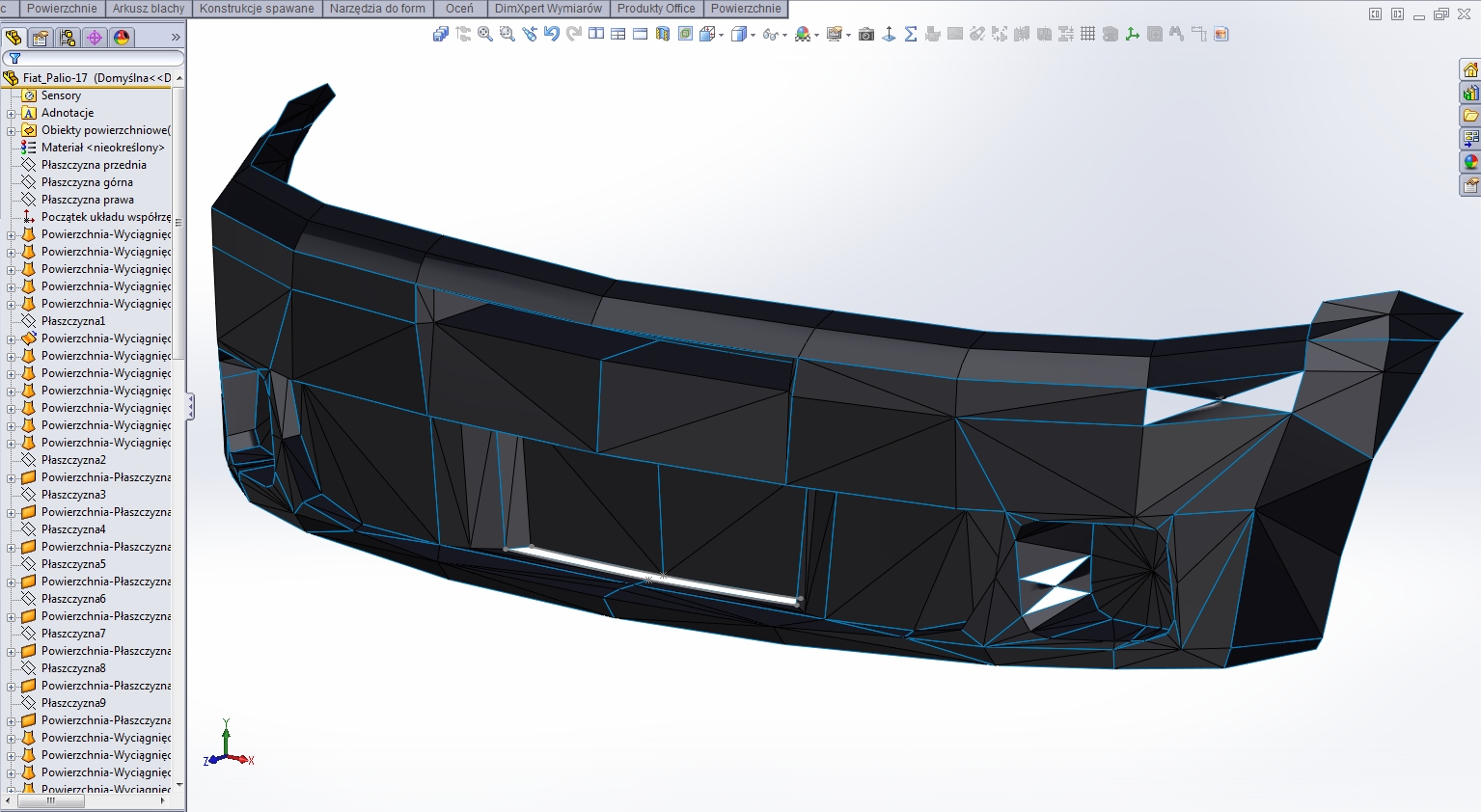

Unfortunately exported object looks very "not smooth" every detail is like mesh covered with planes...
I must model this car by my self in SolidWorks i think.......
i add picture of bumper in SW window - looks very bad.
Yes this is a low poly model. I have tried to use subPatch, LW way to soften things up and add gemetry, but it was not good either. Sorry.
