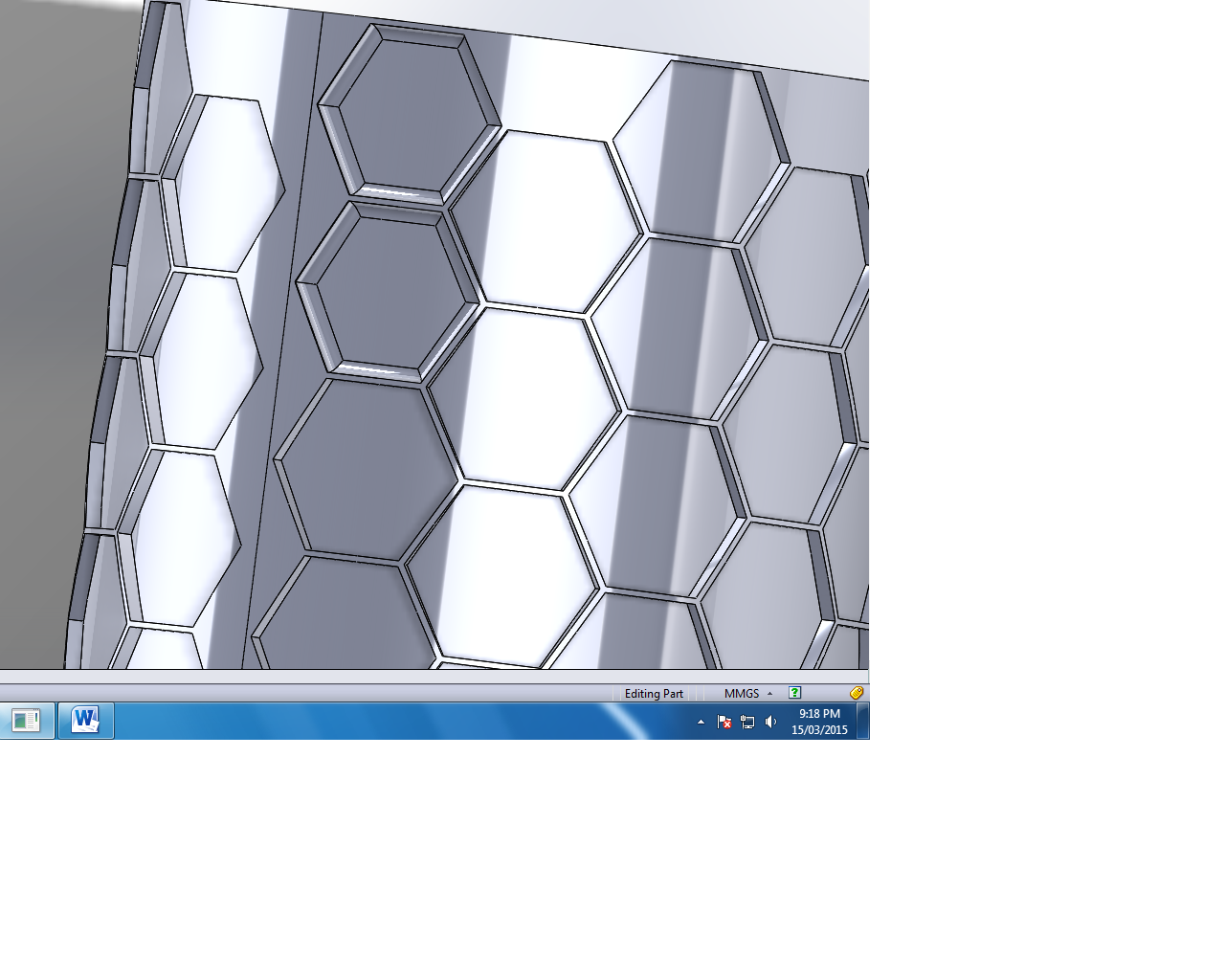

There is a wrapped sketch around a cylinder. A fillet needs to be done on each and every dimple. There are around 200 dimples. Is there anyway to pattern a fillet on the rest of them? Dimples achieved by wrapping a sketch over a cylinder with deboss option selected.
2 Answers
Use filletxpert, when you select the first edge it will show you options to multiple select all the edges or faces of the feature.
Thank you very much Mallias, it worked quite well. Will save me so much time. Thanks again!
