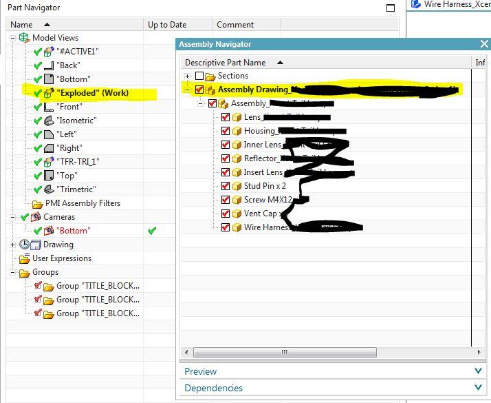

In Nx we need to create separate explode in model and drafting mode.
In Model, i think you know well about expode view shown in modeling environment. So we disucssed drafting below.
In Drafting, After everything completed in drawing, we need to insert the exploded view in drawing.
So we need to change mode from drafting environment to modeling environment in drawing file(Not in your assembly part model).
Then here we need to create Explosion , Assemblies > Exploded Views > Create Explosion
Then next edit the Explosion. Here you will move parts at certain distance. Assemblies > Exploded Views > Edit Explosion
After move the parts in assembly, we need to save the Exploded view in the name of TFR-TRI, View>Operation>Save as or Save TFR-TRI.
Explosion completed now in drawing file(Modeling mode).

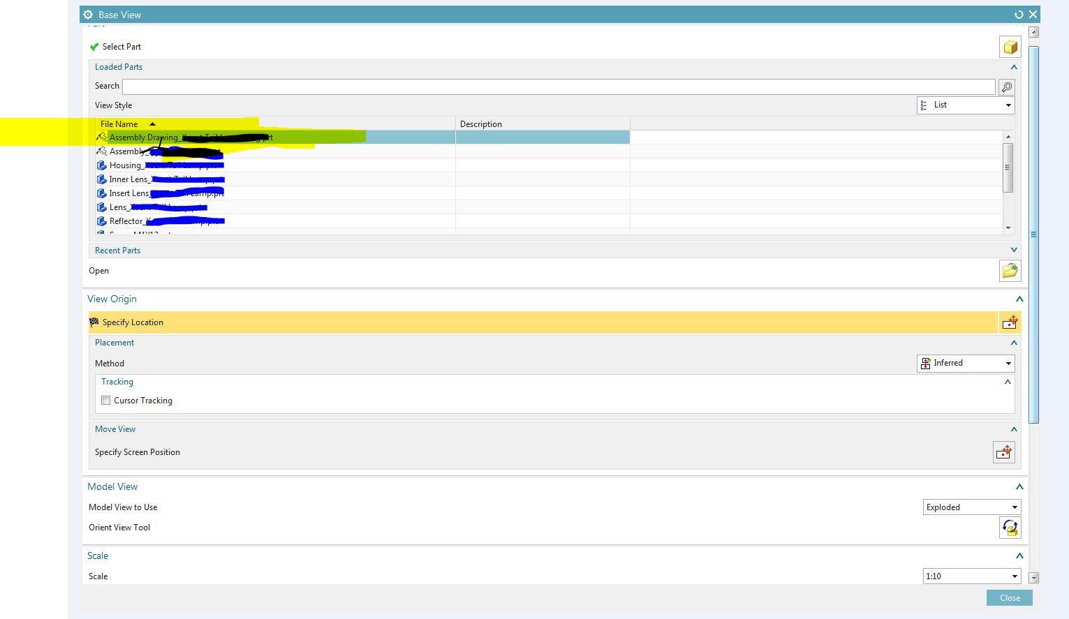

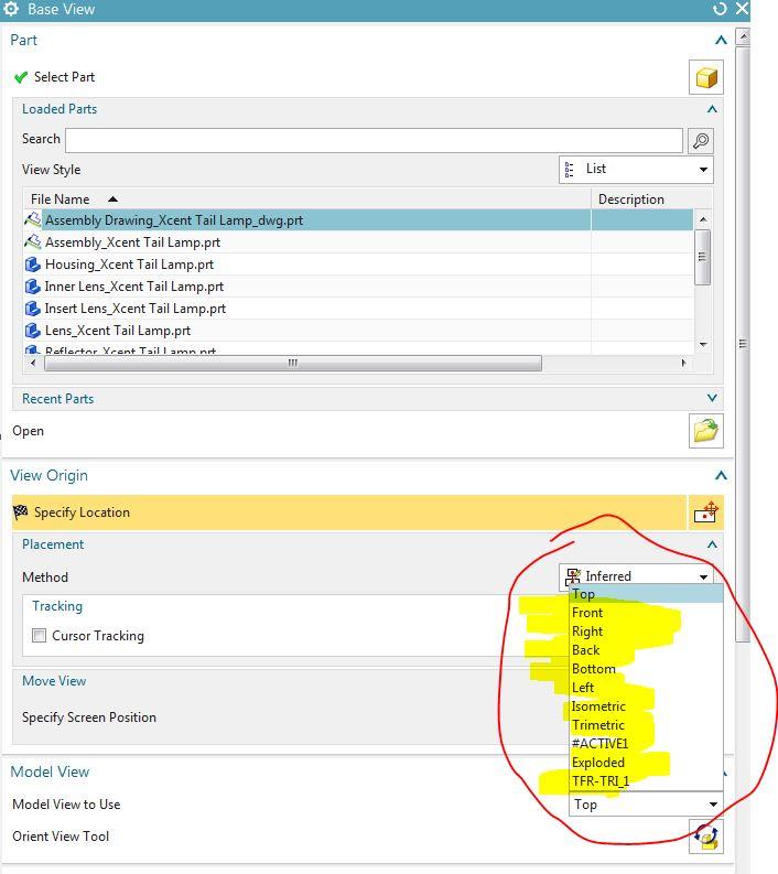

Need to insert the view in drawing. Select Base view>Model view >TFR-TRI> click ok to finish view set.
Check it out. And am waiting for your reply.
While placing base view selection of part is important(in Drafting Mode) , cross check in which part you created the exploded view and select the same part, then only view created will show you, refer attached images.
