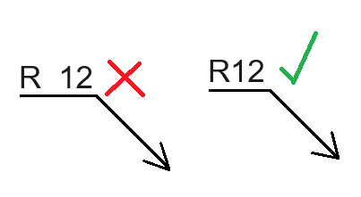

How to remove space between prefix r and value in drafting (CATIA) Lê Văn Ngà 27 Sep, 2023 02:51 AM I want to remove space between prefix R (fillet) and value in drafting (CATIA). Is there any way? Thanks 23927.png 1 Answer Jack K Answered on 27 Sep, 2023 07:16 PM Assuming that is a Radius Dimension and not a Text With Leader, you have to edit the drafting standard (ISO ?) to change the distance between the R and the value. And you need to have Admin privileges' to do that.
