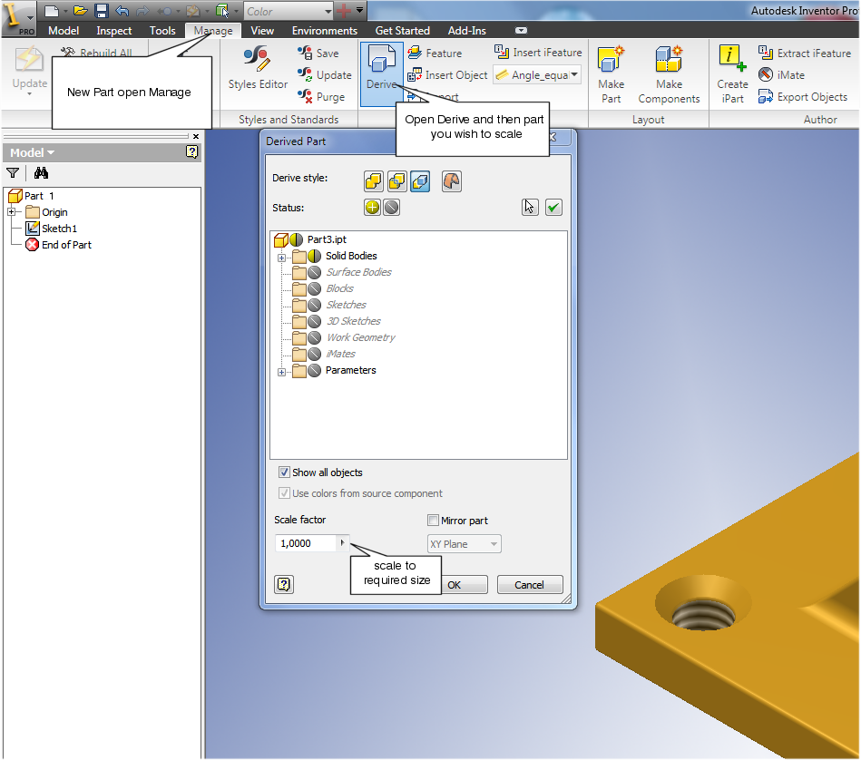

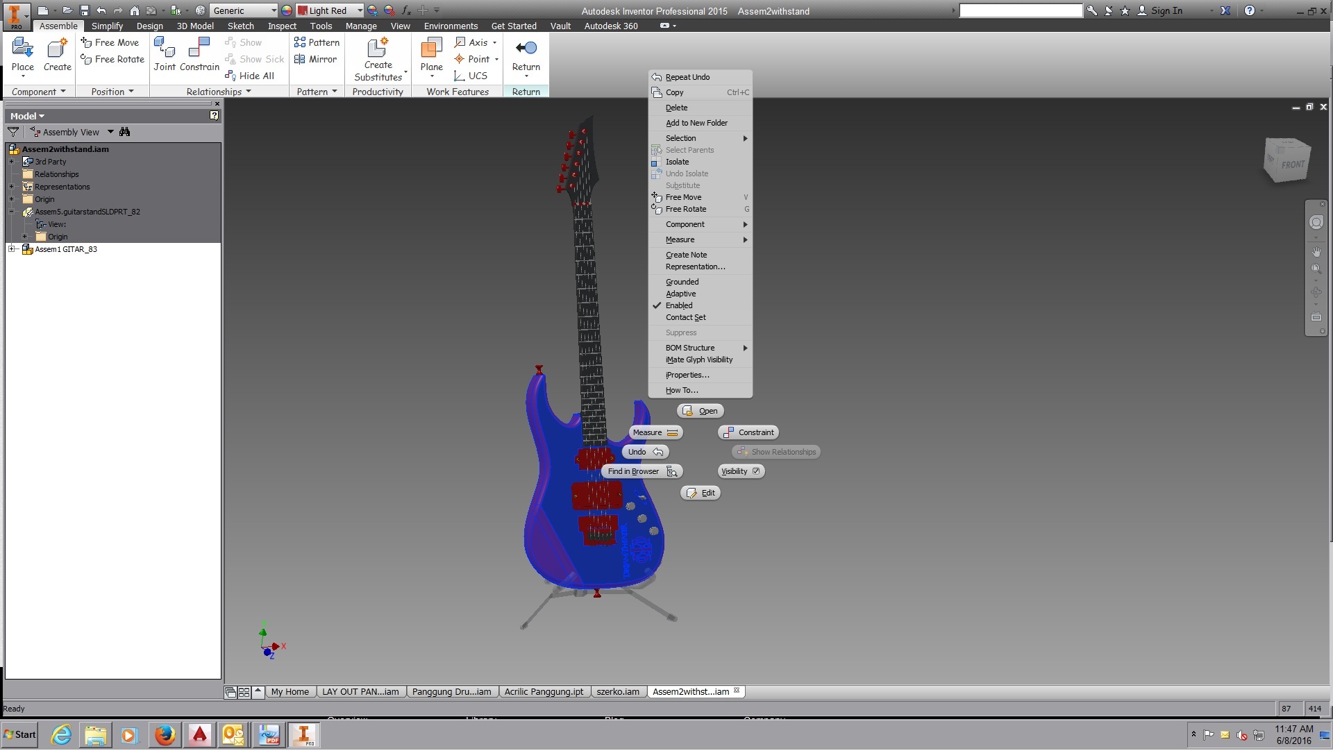

How to scale 3D in invertor without click sketch?? Tulus wibowo 8 Jun, 2016 04:49 AM How to scale 3D in Autodesk Invertor without click sketch?? Guitar.jpg 1 Answer CadCloud Answered on 10 Dec, 2017 10:42 AM Is this what you mean ? Image2.png
