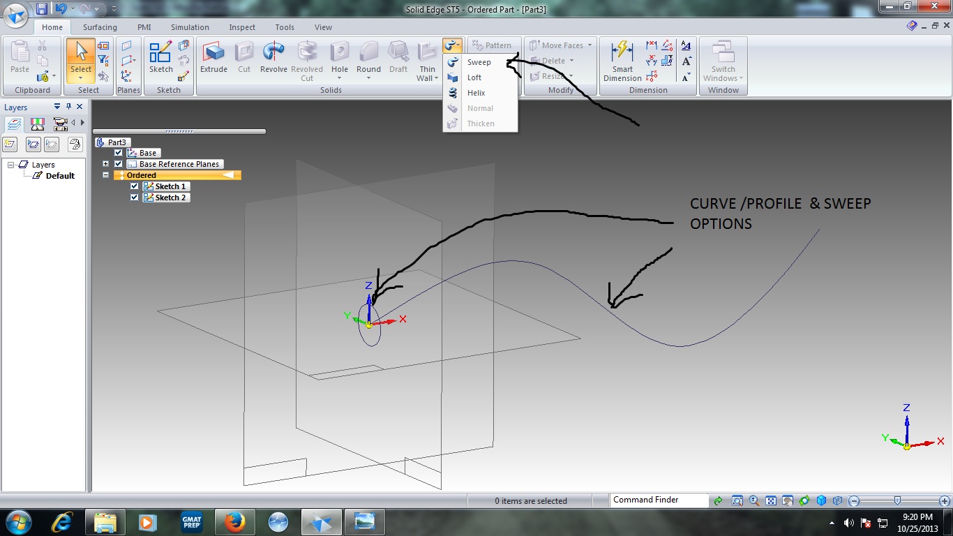

1.select a plane and draw a spline or a curve i.e your path for the sweep
2.now select a plane which is normal that is nothing but perpendicular plane to the plane of the curve.
3. draw your cross sectional profile in the second plane selected

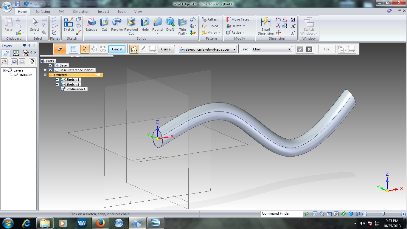

4. go to sweep ,single path and cross section ..ok
5.select path curve ..select ok
6.select cross sectional profile and ok .
thats it ...
