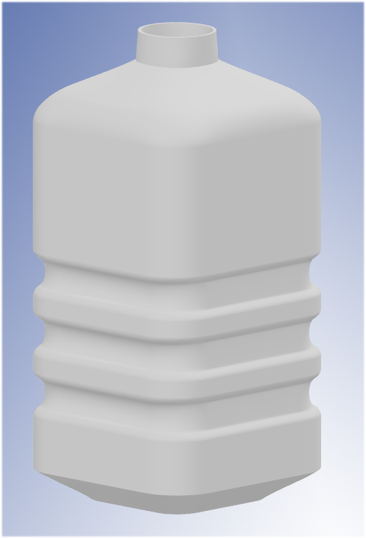

I´m just trying to model a bottle from a SolidEdge book following the multipath profile sweep but I can not do that.
The command gives me an error "the first trajectory is not continuous tangent".
I upload the model I created and I try to do.
Thank you in advance.

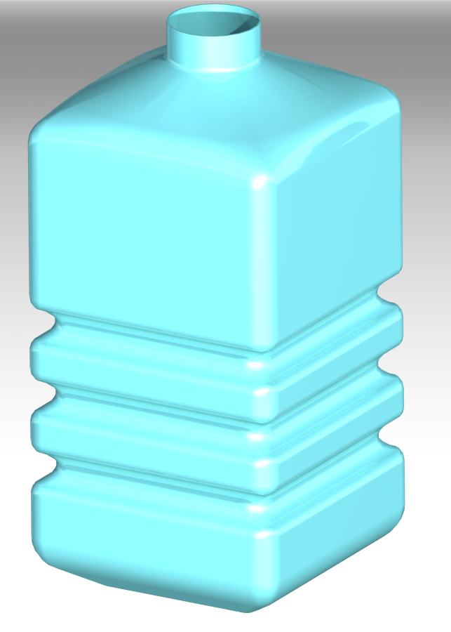

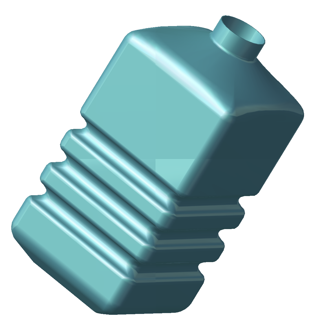

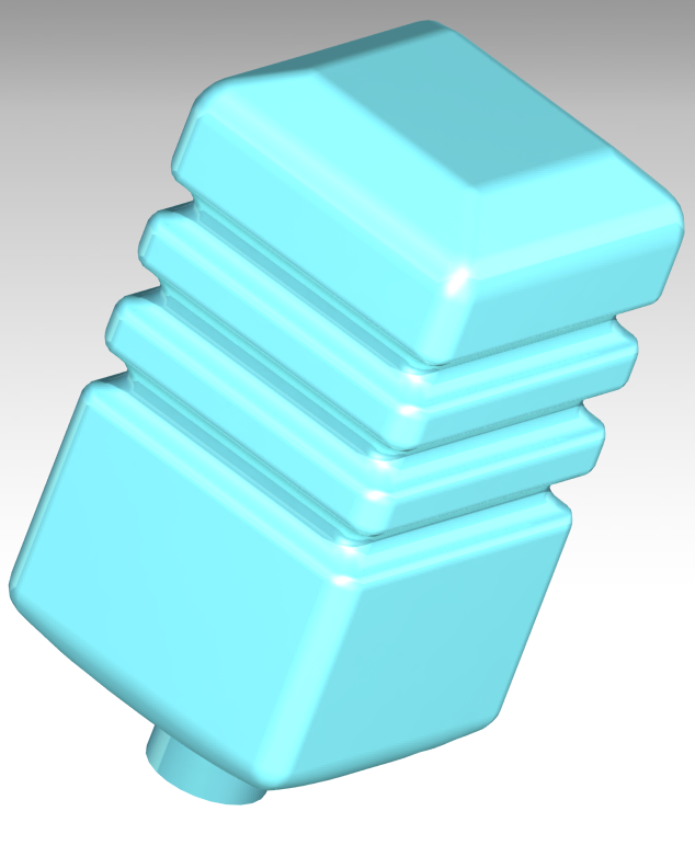

voici comment tu peux procéder.
le fichier botella.catpart est une esquisse de solution.
