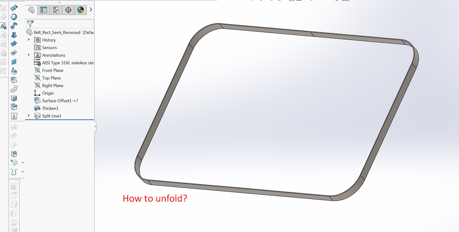

Hello, I need to make a cut out drawing for laser cut for a part that have been done using an offset surface.
Can someone explain me how to achieve it.
One is rectangular, another one is circle.
I tried with Flex but never get it right.
Thanks

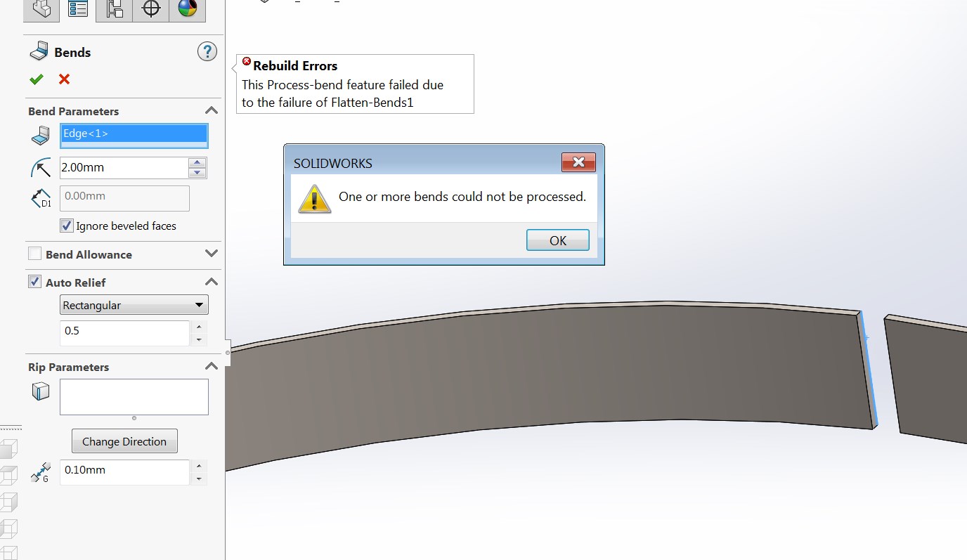

This is the type of message I got while using insert Bends.

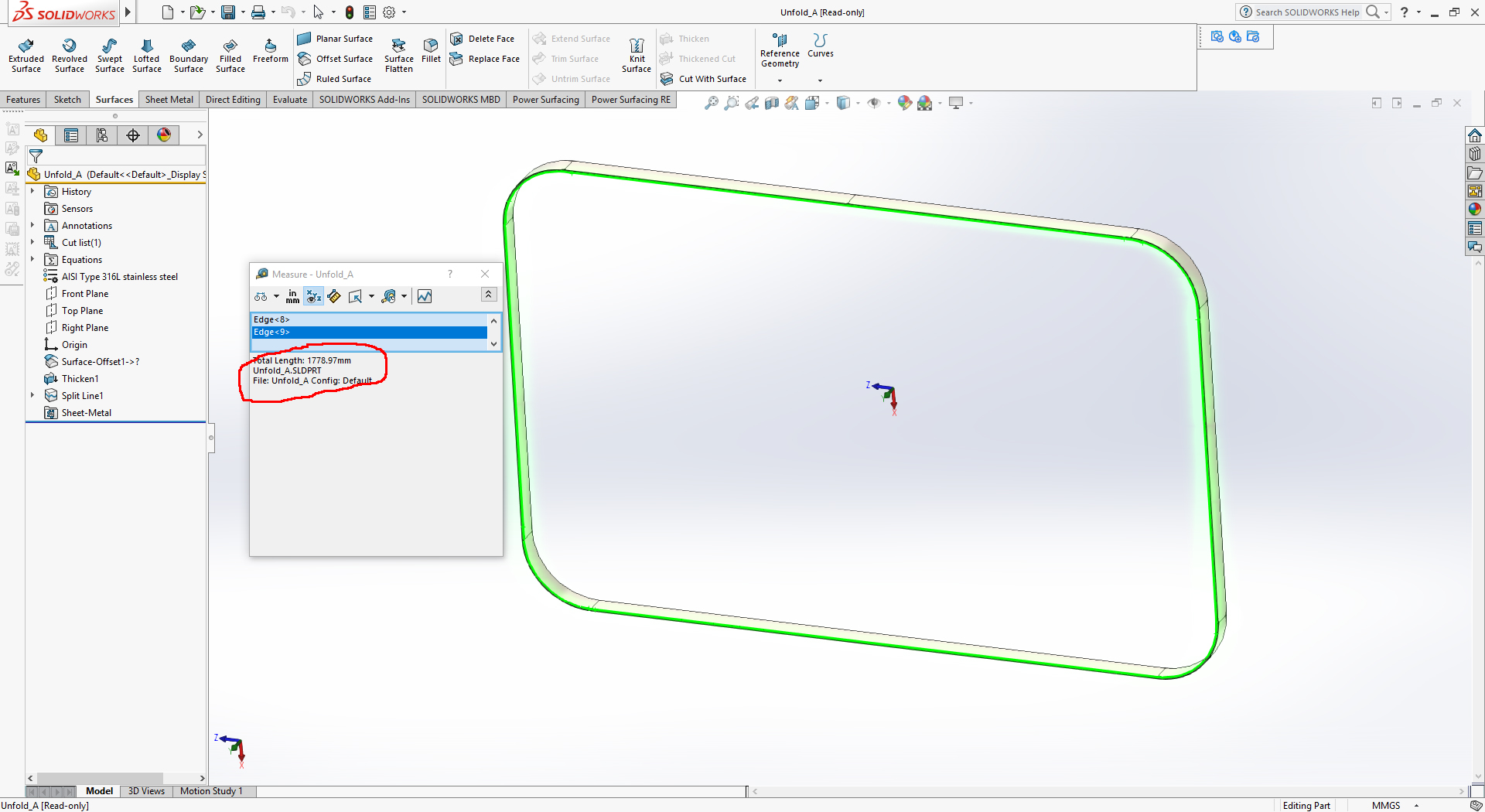

Why are you trying to flatten such an easy piece of geometry? It is just a simple rectangle when flattened....You just need to measure the lenght of the inner loop (tools/evaluate/measure) and draw a simple rectangle as flat surface for cut .
