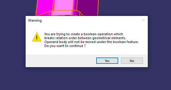

I am having a problem in Catia software while using boolean operation Karthik Kumar 4 Oct, 2019 06:04 AM I use copy the body and past special with link. and I try to remove with main body ,error coming it showing body having a link . how can I broke the link boolean operation problem.PNG 1 Answer Jack K Answered on 4 Oct, 2019 02:18 PM To break the link; Delete the linked, copied body. Then Copy the body again but use Paste Special, As Result.
