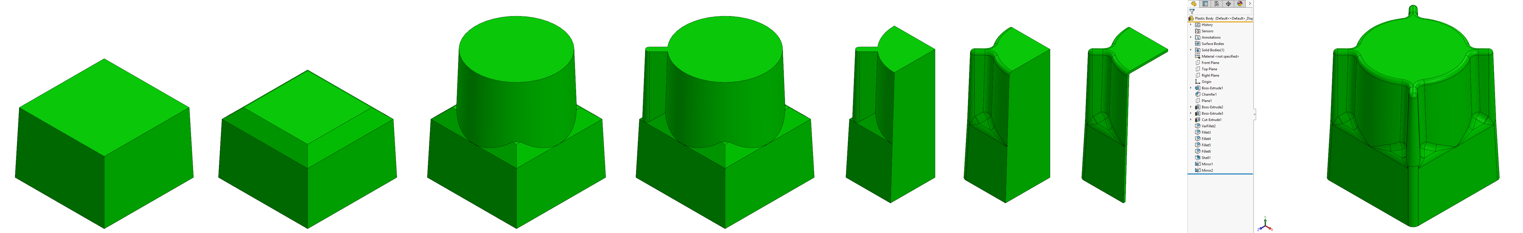

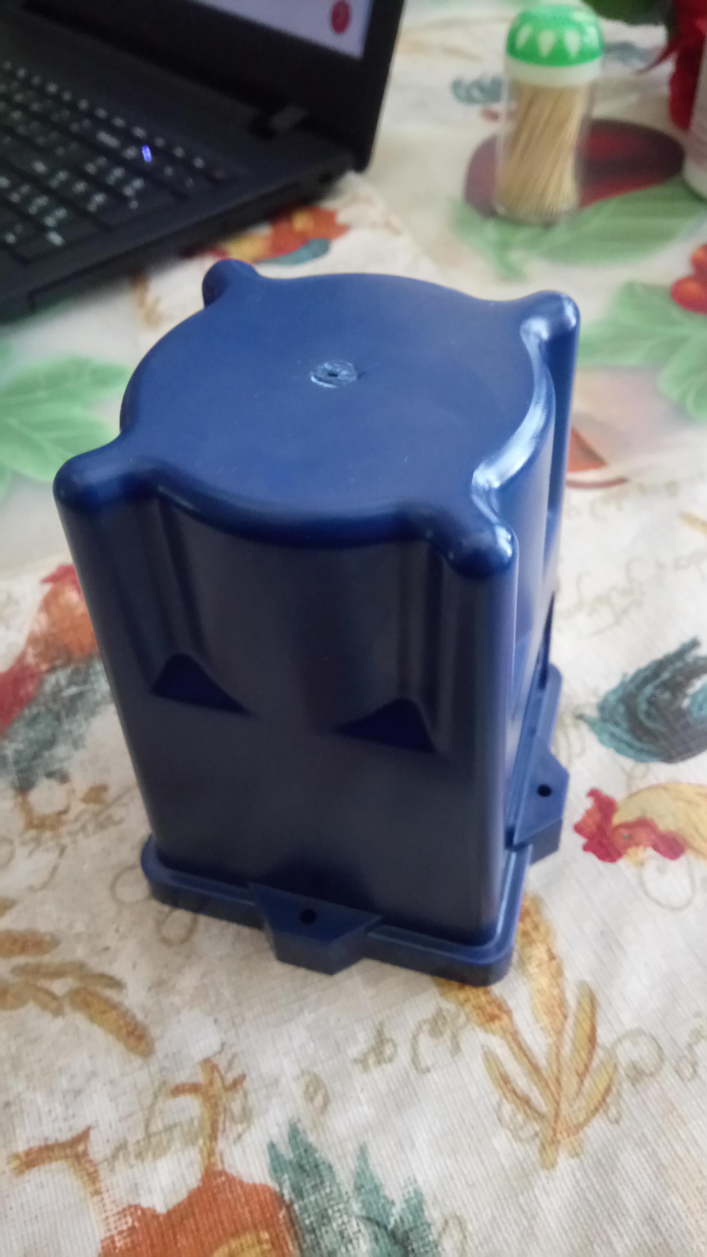

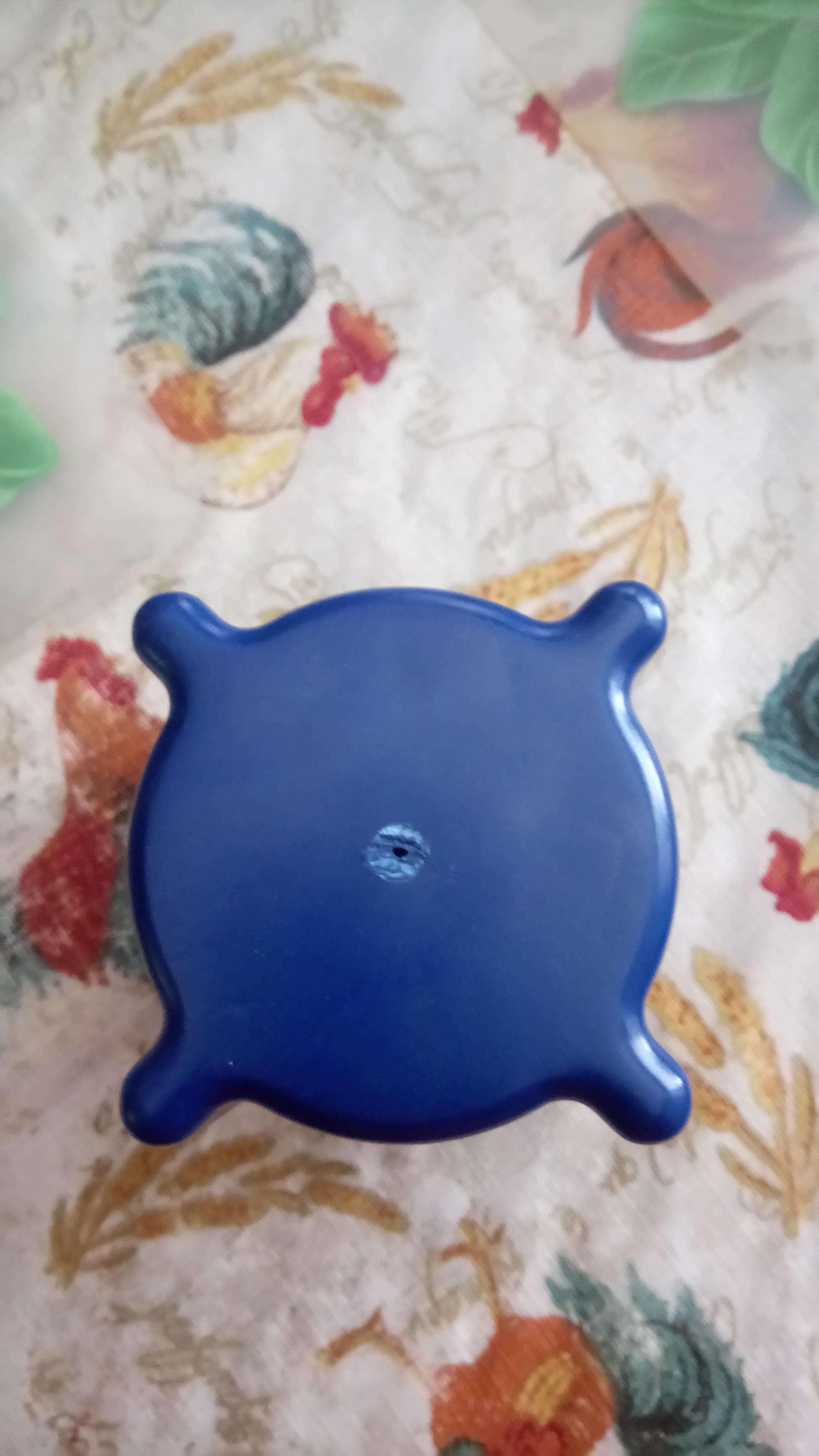

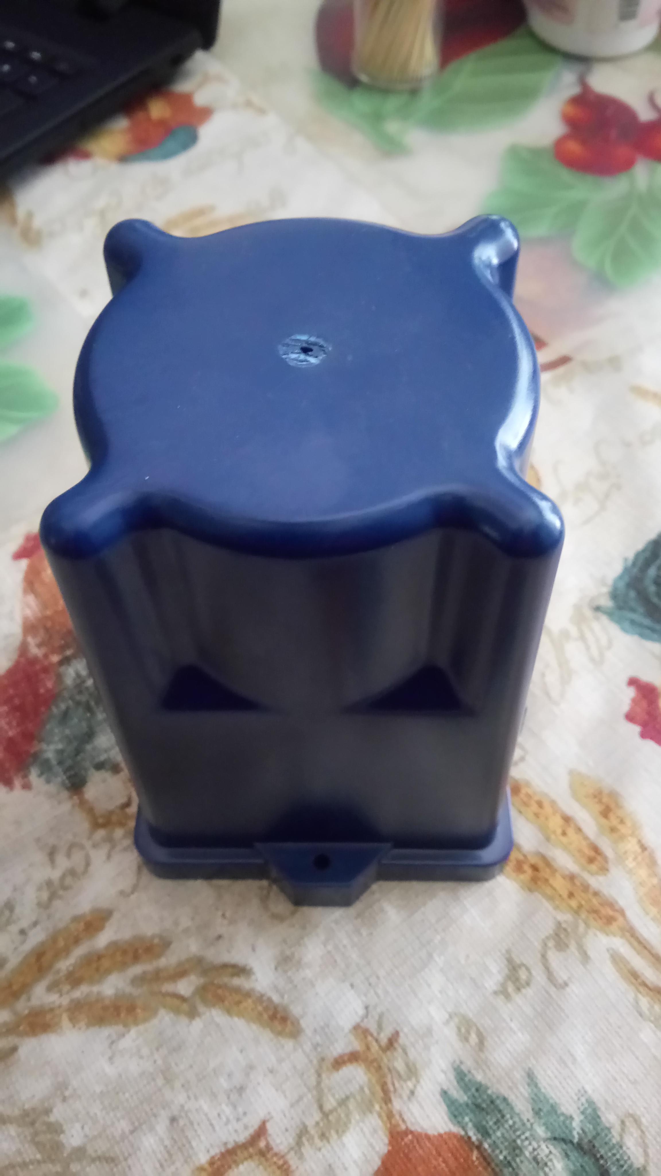

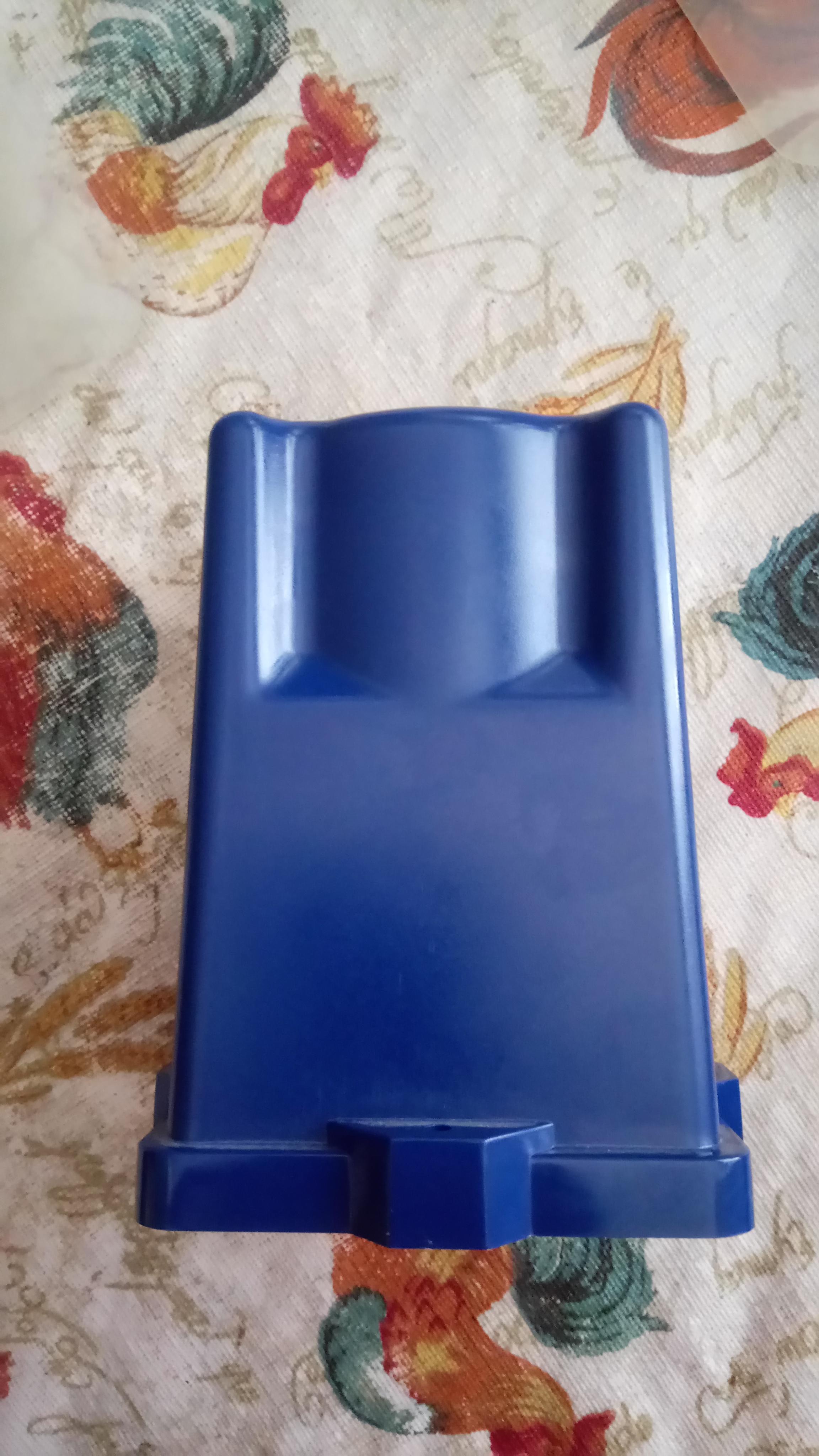

I need help making this shape.
I've run over it multiple times, but I still can't get it right so I gave up. I really need help with the top part, where there are intersections between what looks like two extrusions. That's the part I really need help with.
The extrusion angle being used is 2 degrees, don't care about size.
2 Answers
It looks like a square extrusion, a chamfer, a circle extrusion, then an "X" extrusion to make those little "wings". Finish it off with a fillet.
If you post your SOLIDWORKS model, it will be easier for someone to see how/where it isn't working. Otherwise we have to re-create everything at an unknown scale.
Help us to help you by uploading what you've already tried.
