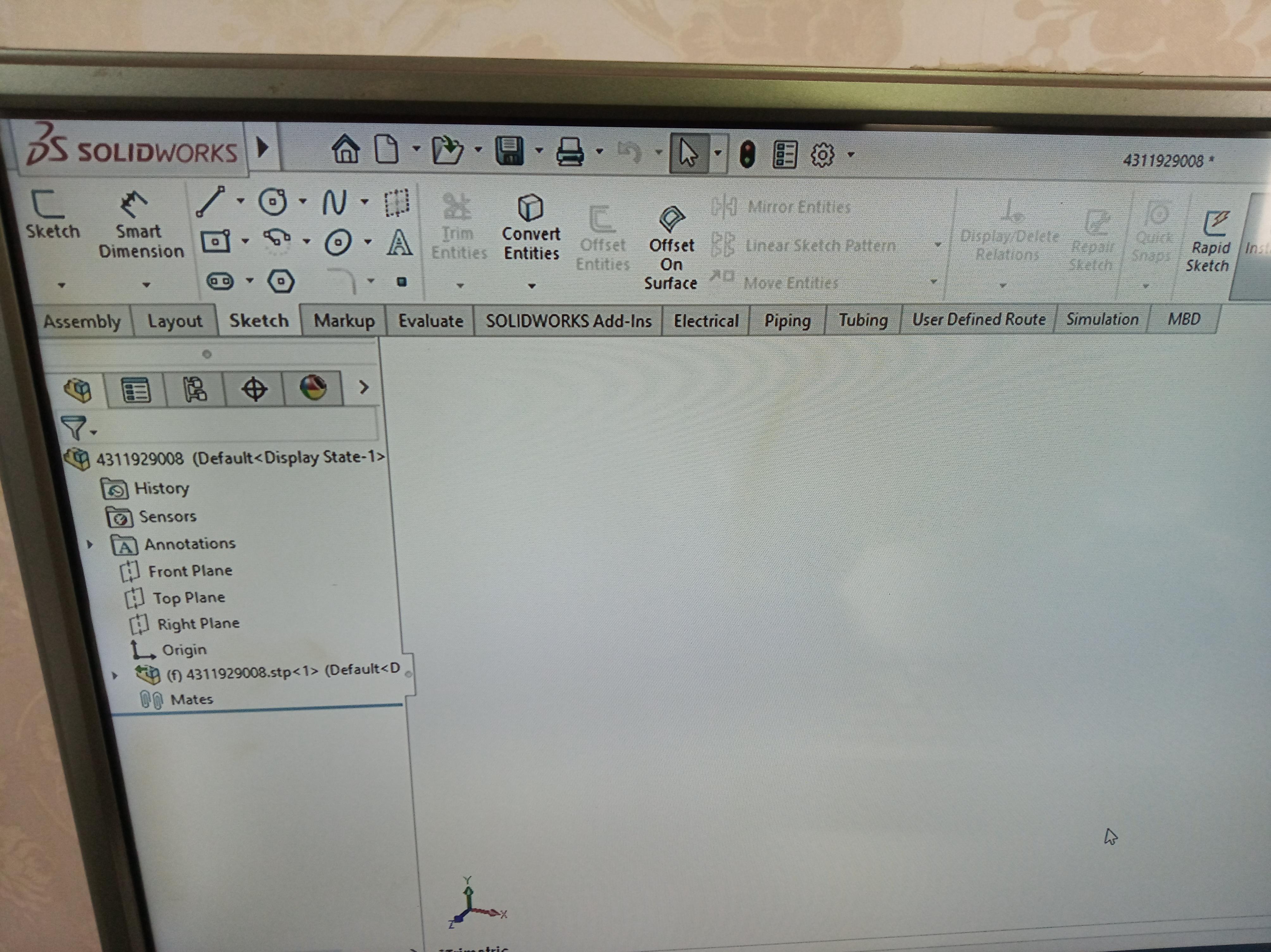

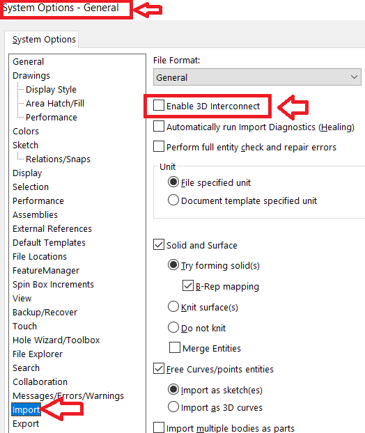

In Solidworks not show STEP file assembly drawing? Piyush K 22 Jun, 2021 06:48 AM I attached screenshot. Not show drawing open STEP FILE. I not understand symbol. IMG_20210622_115256.jpg Accepted answer SolidTweaks Answered on 22 Jun, 2021 07:50 AM The green arrow means 3D Interconnect. You can turn it off under Tools > Options > System Options > Import before importing the STEP file. Interconnect.png 0 Other answers
