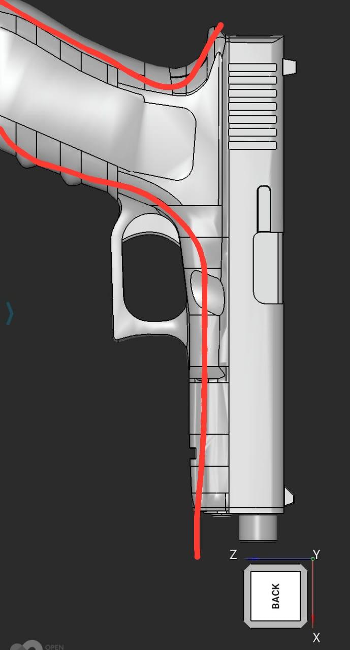

I create 3D model from Scan data with Reverse engineering but the problem is the solid model have some patches on it & I don't need that Patches so i there is any way ?(
Two CATIA commands you could try: Remove Face or Remove Lump (Boolean Operation).
If these don't work, please attach a picture showing the CATIA file and highlight the patches you want to remove.
