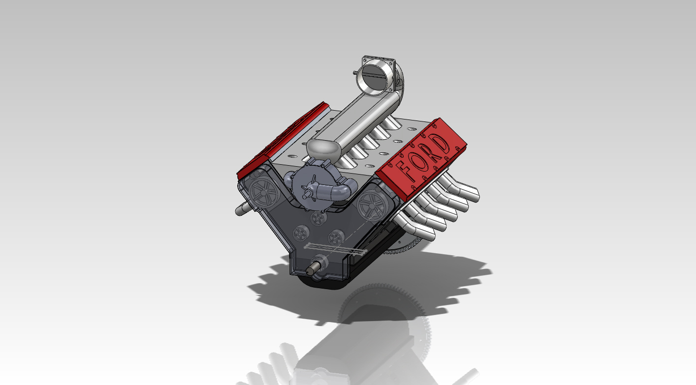

I am having slow performance problems when working with larger assemblies and motion study. Specifically when trying to do motion study for a valvetrain of an engine. Using contact points, springs and motors. Takes loads of time just to calculate. I'm not sure if it's the way i'm setting up each component, or just my system or settings. Also just maneuvering a large assembly is extremely slow.

Sometime contact surface takes very large amount of memory. In that case defining individual contacts rather than all in one yields good result. I will prefer you to define different contacts rather than all in one. :)
Rube Goldberg Machine animation was taking more than 30 minutes on all in one contact, But when i defined different features for contact than it took only 10 minutes in Analysis.
