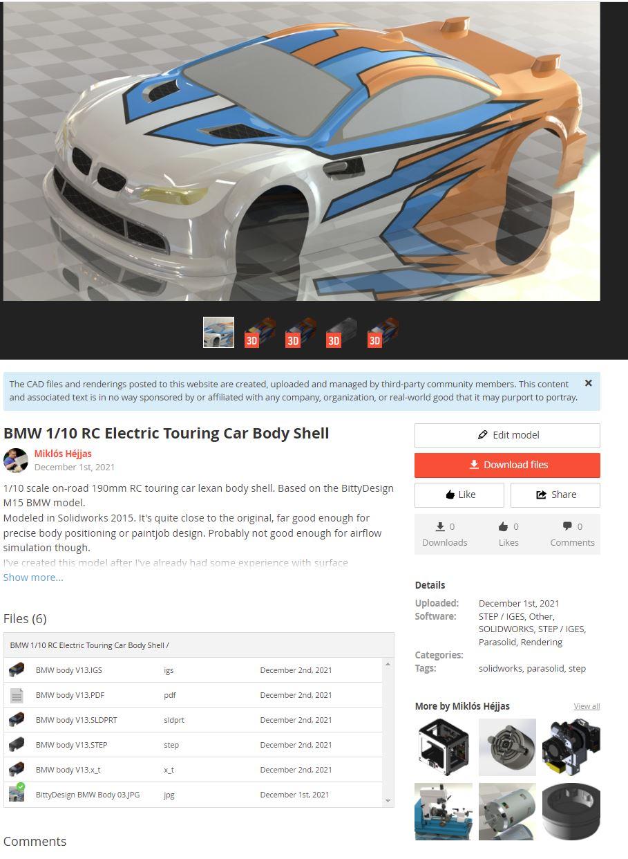

I've tried to share this model of mine multiple times, but no matter what I do, it never appears in the public library. I can see it among my models, but only if I'm logged in. As you can see I've uploaded a lot of different 3D formats

The best solution is to not rely on the built in 3D viewer to generate library images.
Uploading your own screenshots, or renderings to the Library allows you to control how the model is seen. Uploading a neutral file format like a Step file will allow more people to use your file(s) as well.
