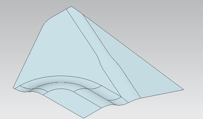

Need help in surface design..
how to flat a complex curved surface?
need to calculate required flat surface to covering purpose.
sharing igs file.
please solve & share making process. i need model in catia or ug nx but as your comfort .
for verification surface area of blended surface & flat surface would be same.
2 Answers
Go to http://youtu.be/iT0QTSVYOTk
Perhaps you can use this approach to get the area to cover up your model. But regarding flattering the surface, I'll check out....
Rupesh, check this out
http://www.exactflat.com/3D-to-2D-CAD-Model-Flattening
This software uses an advanced FEA solver to flatten surfaces with multi-axis curvature.
