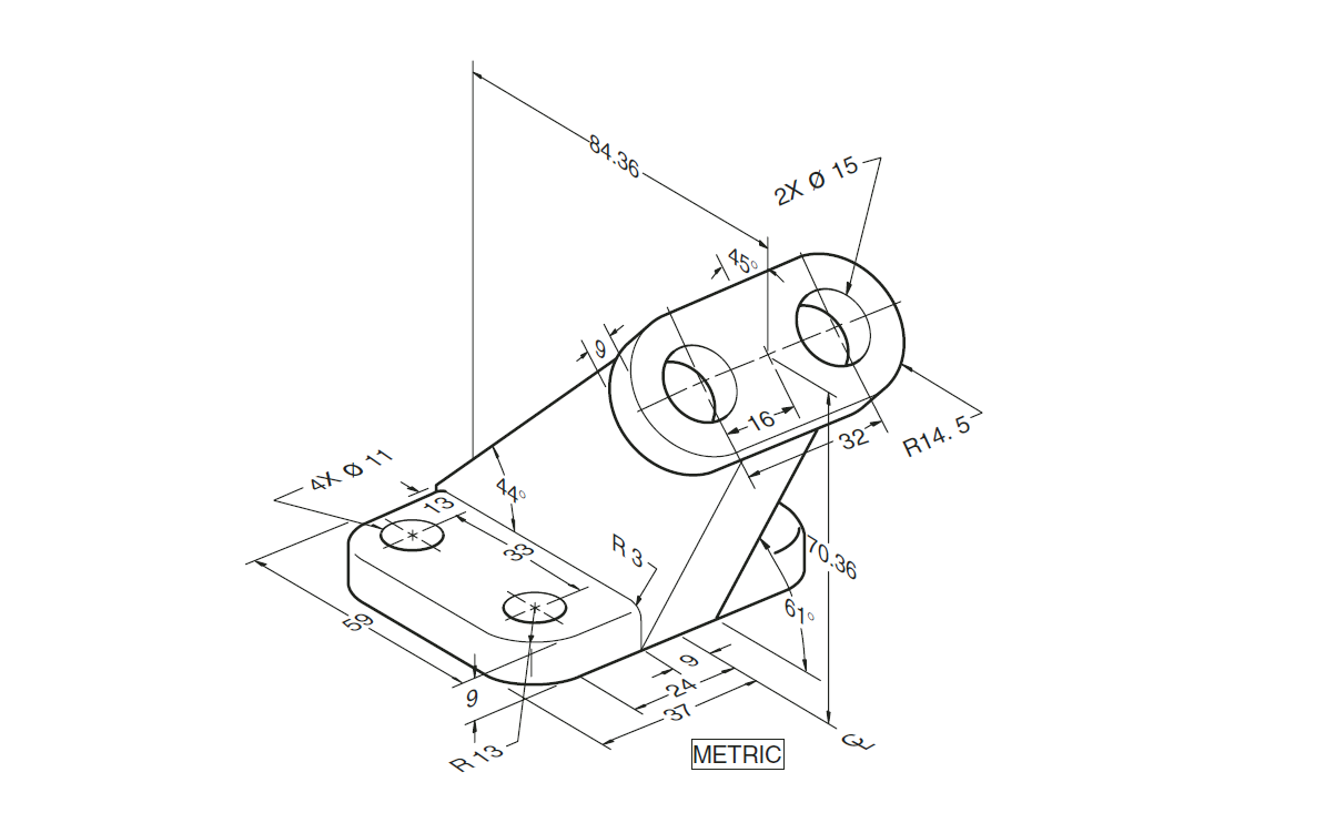

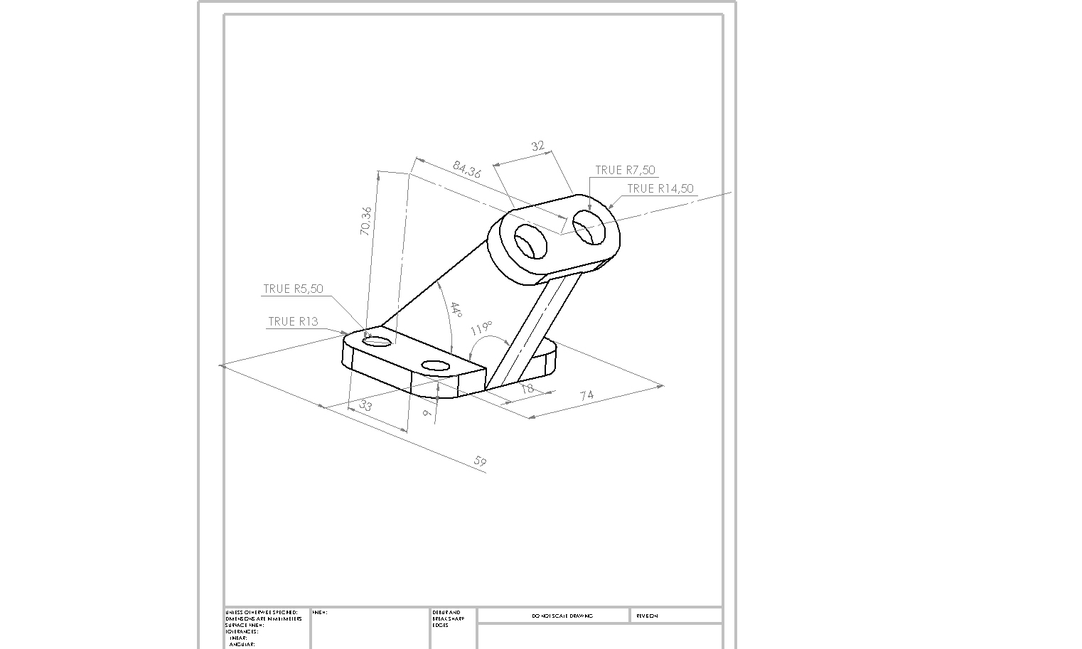

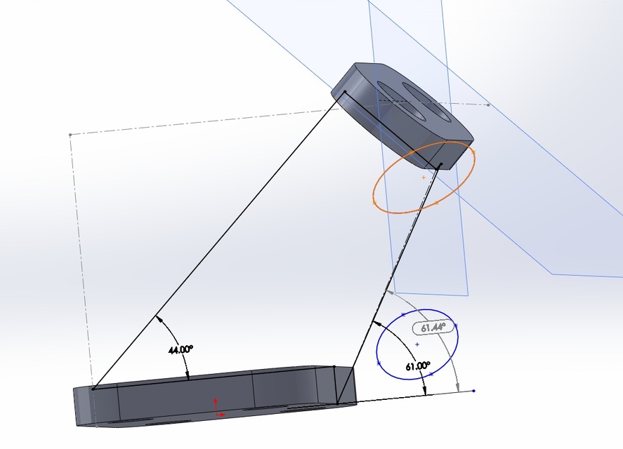

I made a part out of the drawing in solidworks. Please someone check it- if I've done it correct.
I've uploded both the drawing and the part.
P.S:- I have some confusion in reading the drawing.

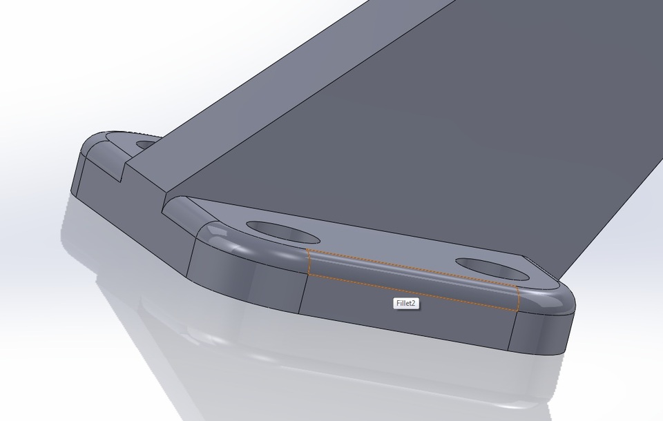

As far as I can see, the model was built exactly to the drawing. You could have make the filet in the initial sketch for the first boss extrude (smaller file size - less features) but it's ok.
Well done.
Looks correct to me other than the above mentioned fillet.
Same here . I agree with those guys and bravo ! :)
