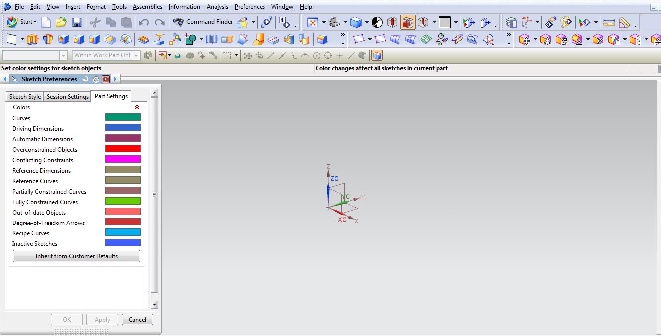

nx user question aea7f2fa 21 Mar, 2015 01:49 AM how do i set my sketch colors and other preferences permanently i tried customer defaults but that didnt work thanx 1 Answer 82d936ba Answered on 20 Apr, 2015 09:35 AM Preferences ....Sketch....Part Settings 1.JPG
