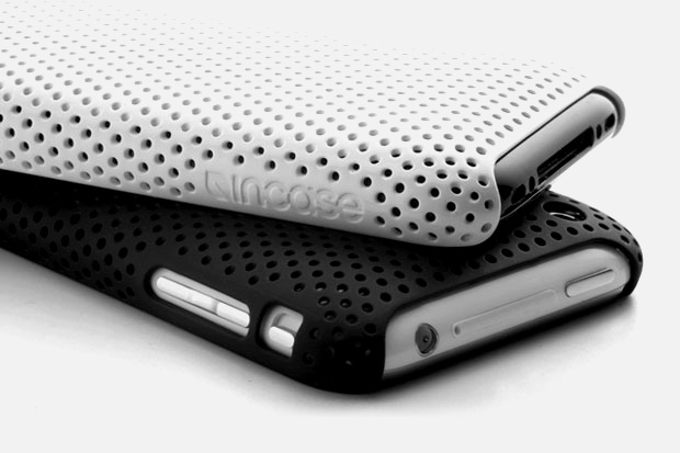

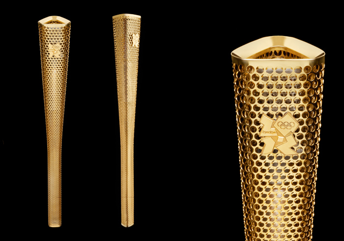

How do I put a pattern on a curved surface so that each element of the pattern is parallel to the curved surface? I cant figure it out, would it be a curve driven pattern? Anyone know of any good tutorials for reproducing similar forms? Thanks!!!!!
