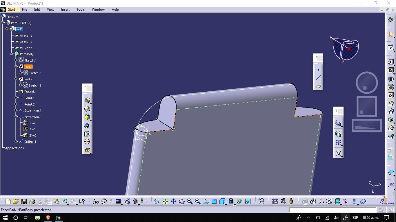

Perpendicular loft in CATIA?
Im designing a phone case in CATIA, made two perpendicular pads and need to enclose the corners, trying with Multisection solid, but gets error. I've been tried differents closing points, or surface fill but nothing.
Accepted answer
You can try surfacing there directly, extract both sides. Use multi-section surfaces and, then comeback to part modelling, use close volume or sew surface tool.
