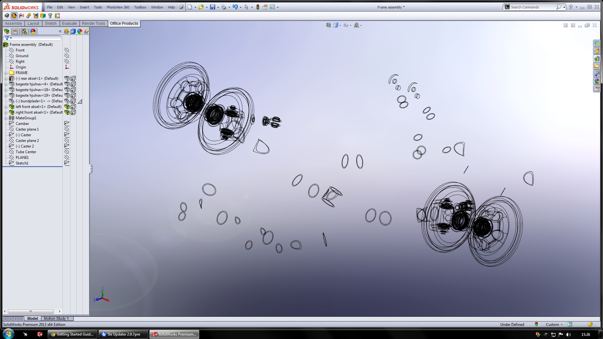

Problem when rotating a model in assembly mode?
Have a question if some one cnows if is it somwhere in the setings i kan chenge so i kan se a ful model when i rotate it her what hapens when i rotate it....
3 Answer

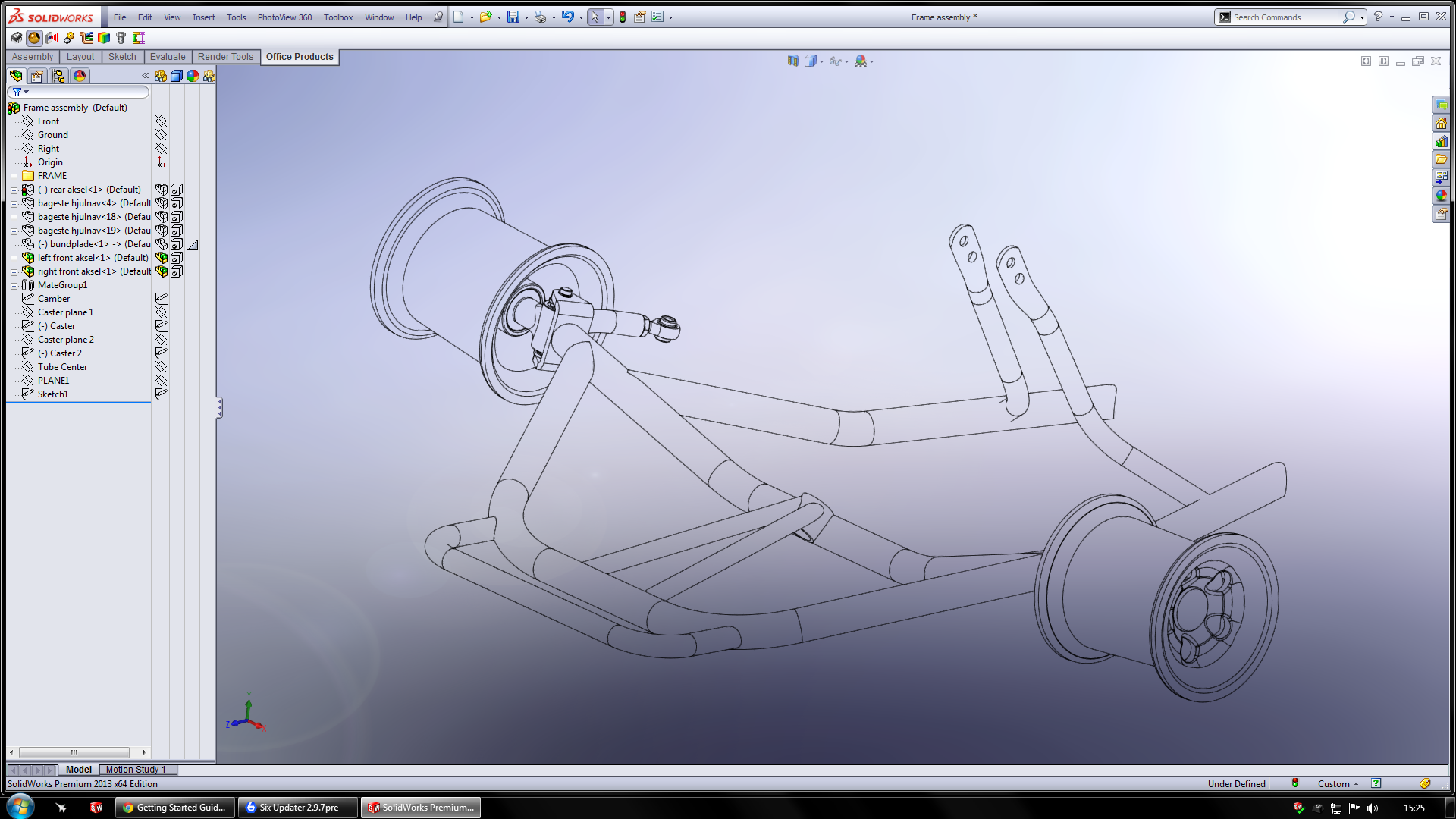

thats strange. Well, change your Display style into "Shaded with edges".
Does this error occur then aswell?
there is no problem in Shaded with edgs :( this realy anoing me will try to disable SLI maby it helps.
It is most likely video card related. If you go to tools>>>options, under performance, is use software open GL grayed out? If not, tick the chceckbox to activate it and click OK.
If it is grayed out, you'll probably have to tell the software to use the open GL option directly in your video card settings.
