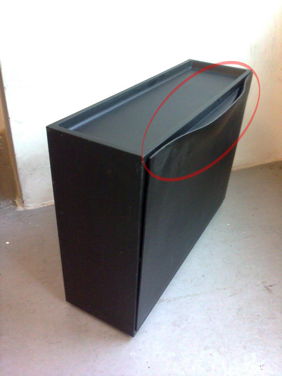

Hi!

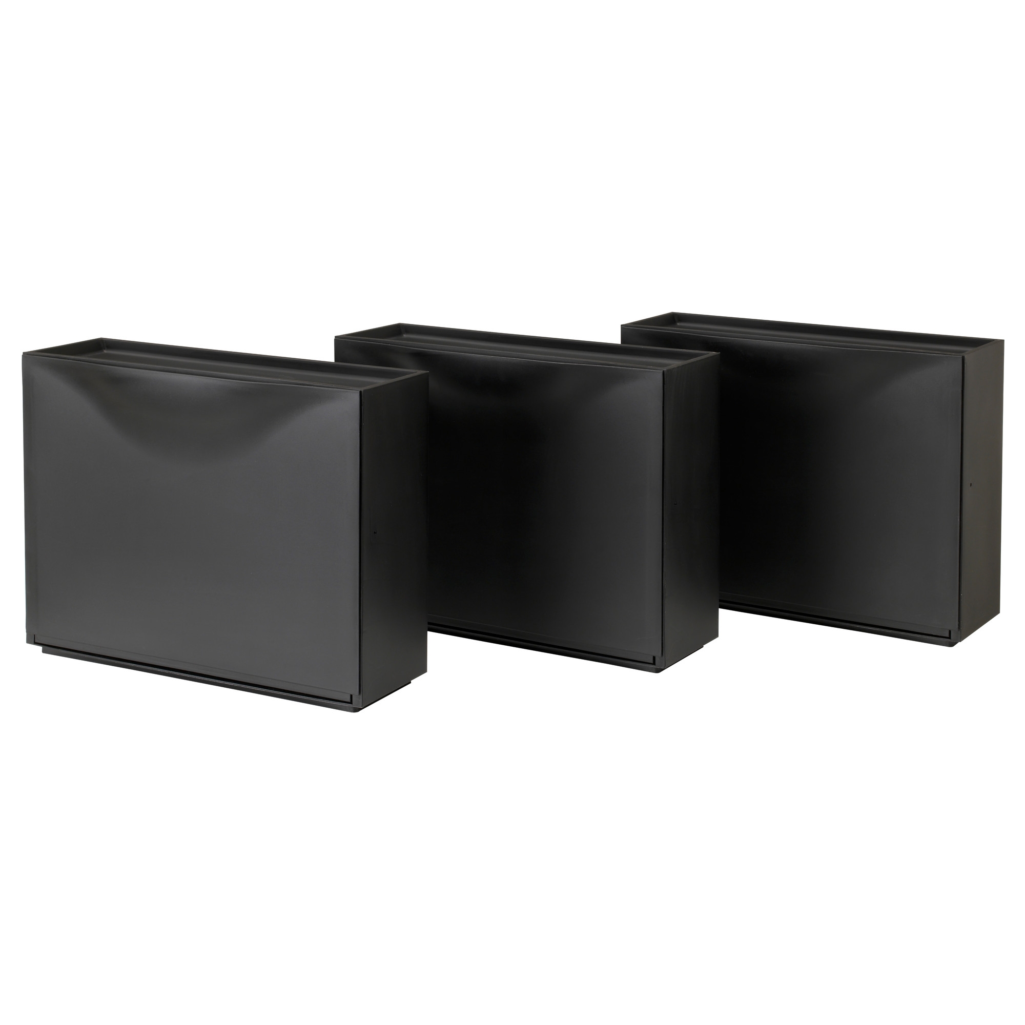

I have problems making a "wave" looking handle(see attached file). tried to use splines and loft but couldn't make it work.
I'm quite new to inventor,Any suggestion on how i can make this.
Thanks

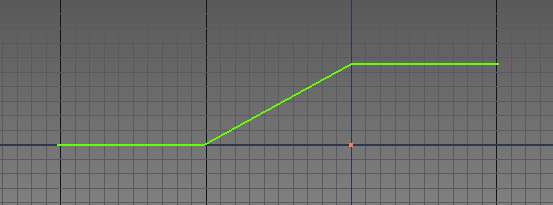

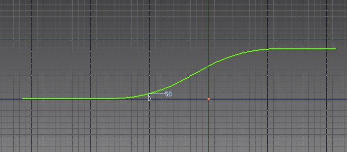

Tula, to make the first line you can use either the Spline primitive (F1 for help when cursor is over spline button) or line tool, in this case you can draw three lines then use two time fillet on them (and mirror)
Here I used the Splines, Loft with rails, to make a surface to thicken to increase the continuity of the surface. Which can kind of be tested with how much you can thicken a surface IMO.
