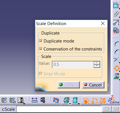

Problem with SCALE tool in sketcher satheesh reddy buma 23 Feb, 2016 08:38 AM scale tool is opening and the two chuck boxs are also able to check/uncheck but unable to give scaling factor and its not showing OK button Screenshot (1).png 1 Answer özgür kesebir Answered on 23 Feb, 2016 08:54 AM First select objects then they will enable.
