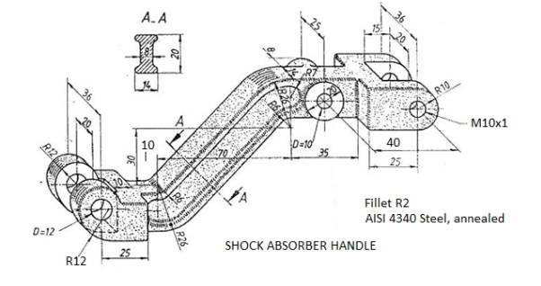

How do I get the angle while constructing this in CATIA
Accepted answer
How do I get the angle while constructing this in CATIA?
The dimensions on the attached image are not very clear, but I think the angle of the center section is defined with the horizontal distance (70) and vertical distance (30) between the center axis at both ends. To sketch the angular lines, you must first draw the radii at both ends and then add tangent lines between those curves.
