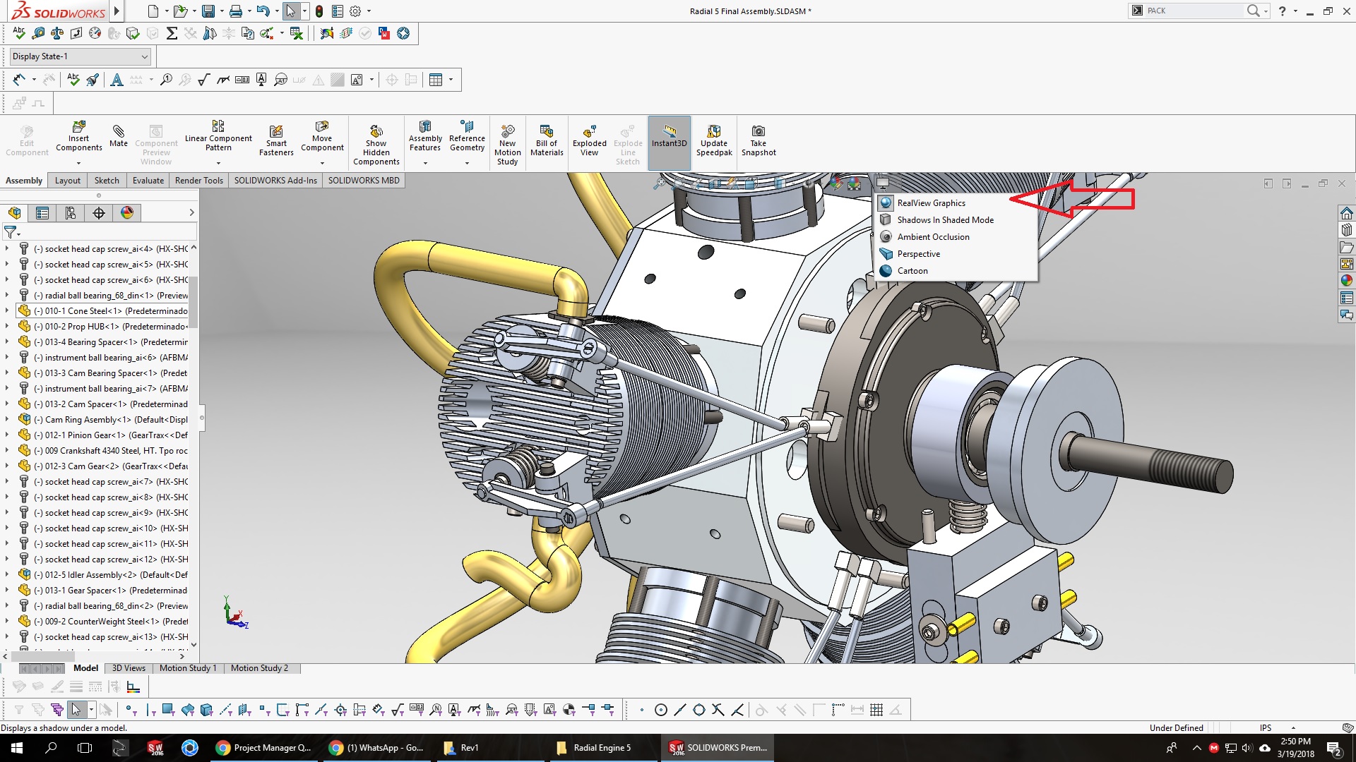

Hey Guys,
My very first question to this great community. I am a newbie to the SolidWorks, and I am on very initial stages.

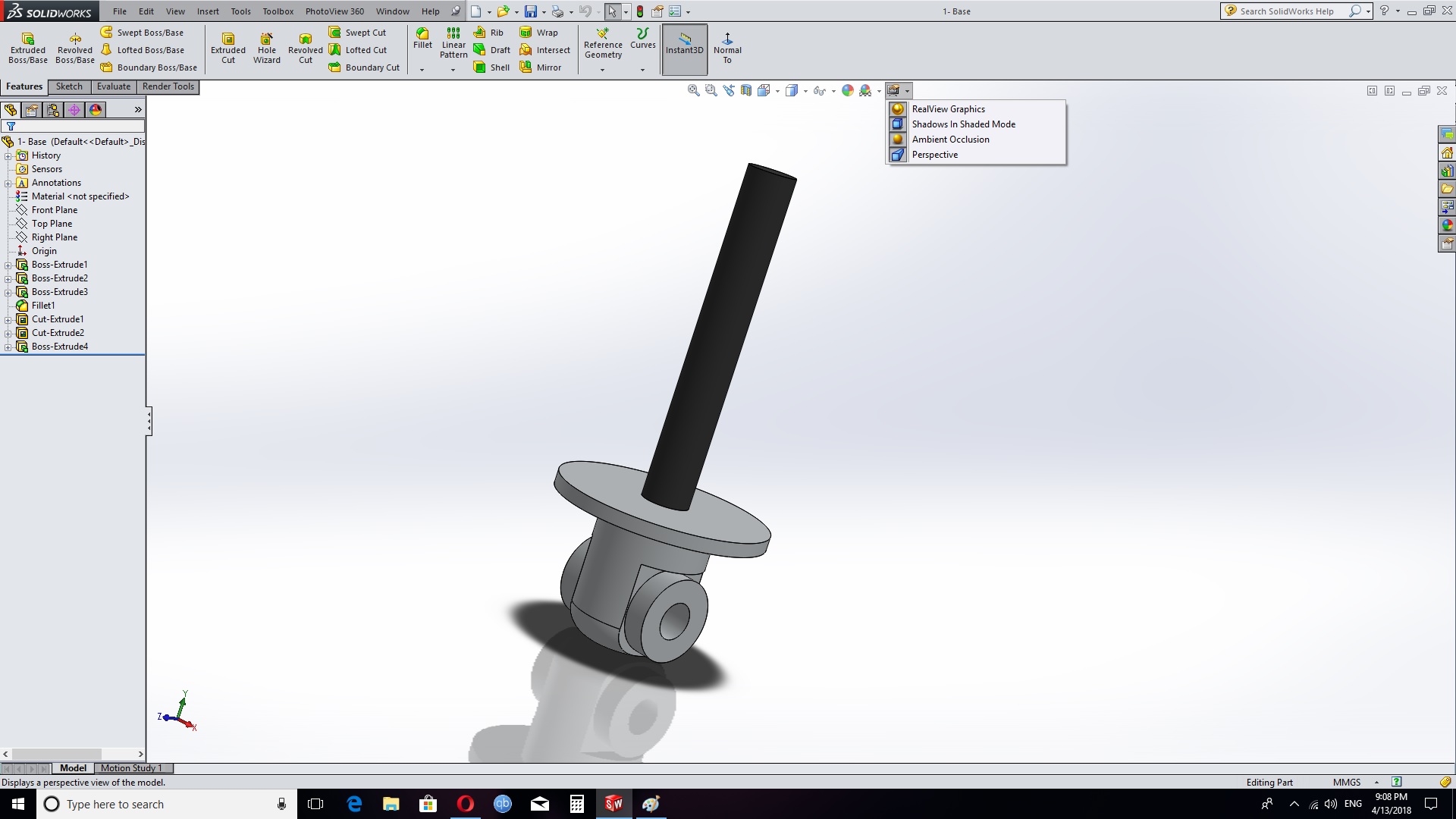

I have AMD RX480 graphics card installed in my pc and I enable RealView Graphics via RealHack tool, but I am not able to get the results as i see on many video tutorials. The surfaces are not shiny/reflecting as you can see in the attached picture.

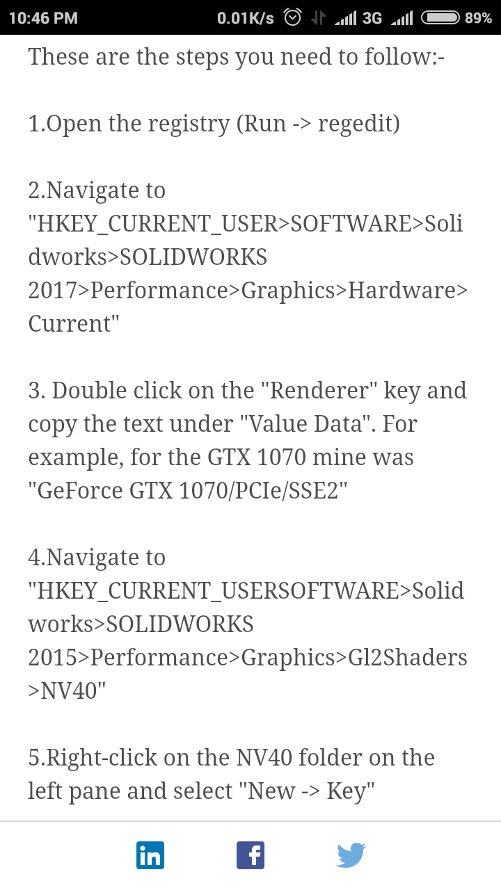

https://www.youtube.com/watch?v=Km5h8OhMJiI

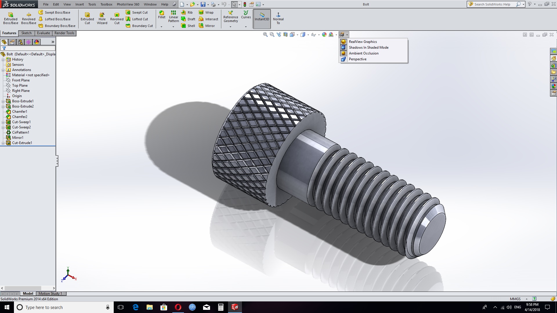

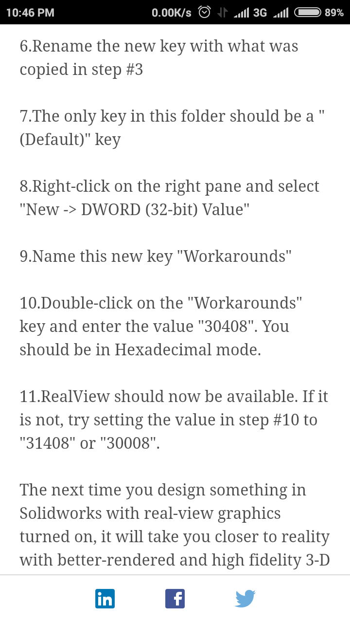

Check this video , the audio is in spanish, but the audio is not needed, just follow the steps, a lot of user from GRABCAD had great results
thanks guys, its activated and works great
