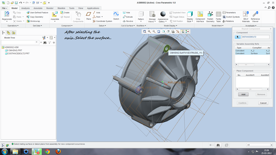

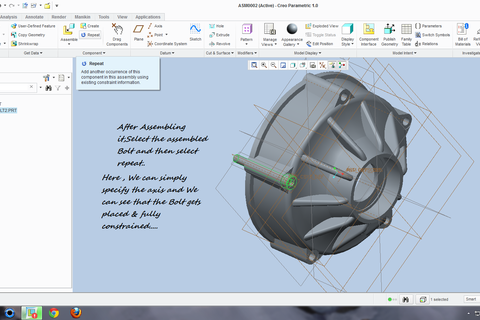

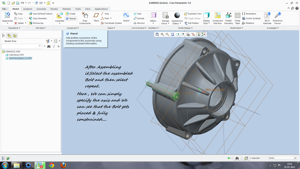

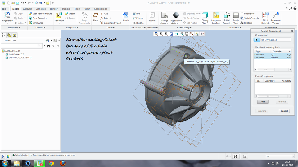

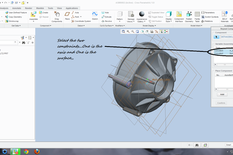

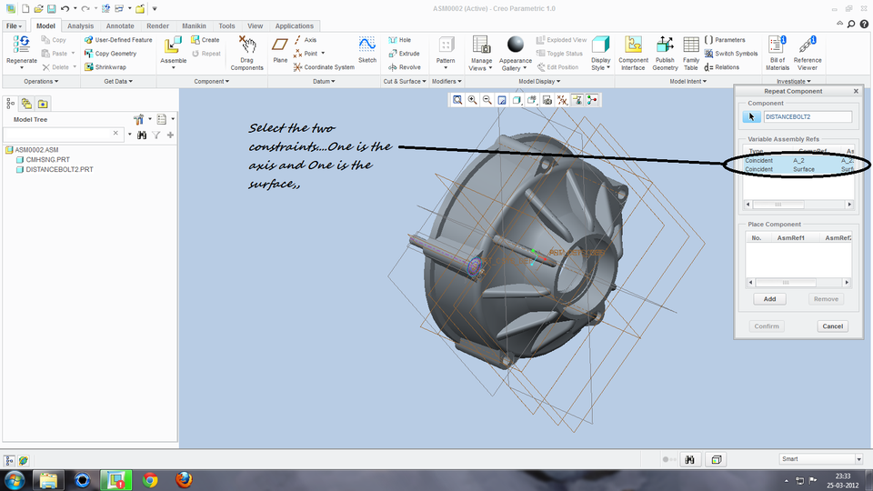

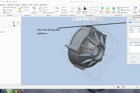

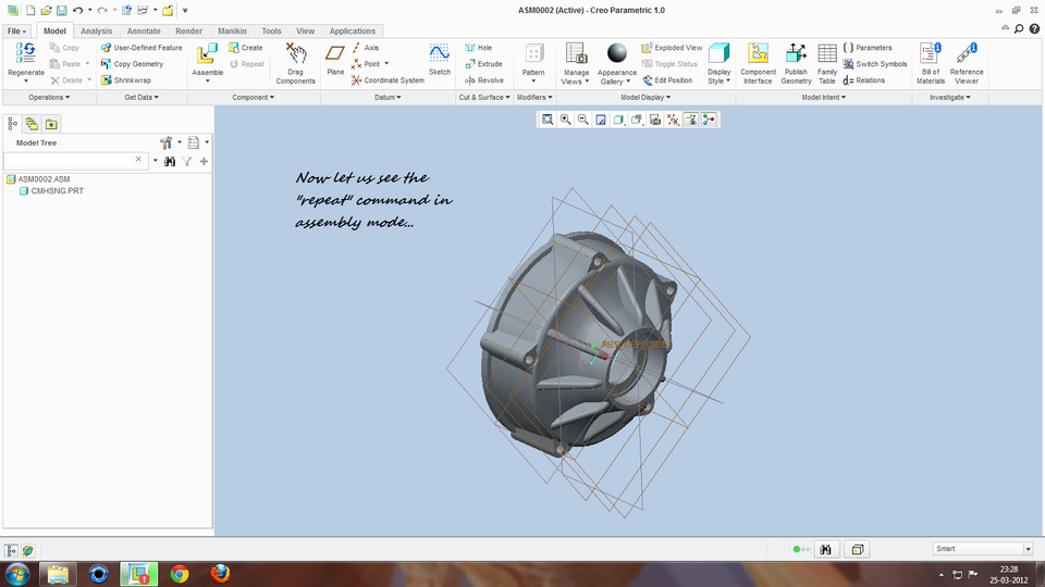

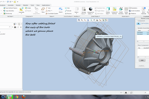

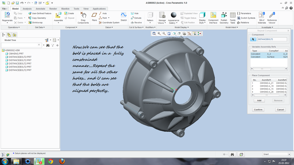

Here's a small tutorial on how to use the repeat command in assembly mode of proEngineer
2 Answers

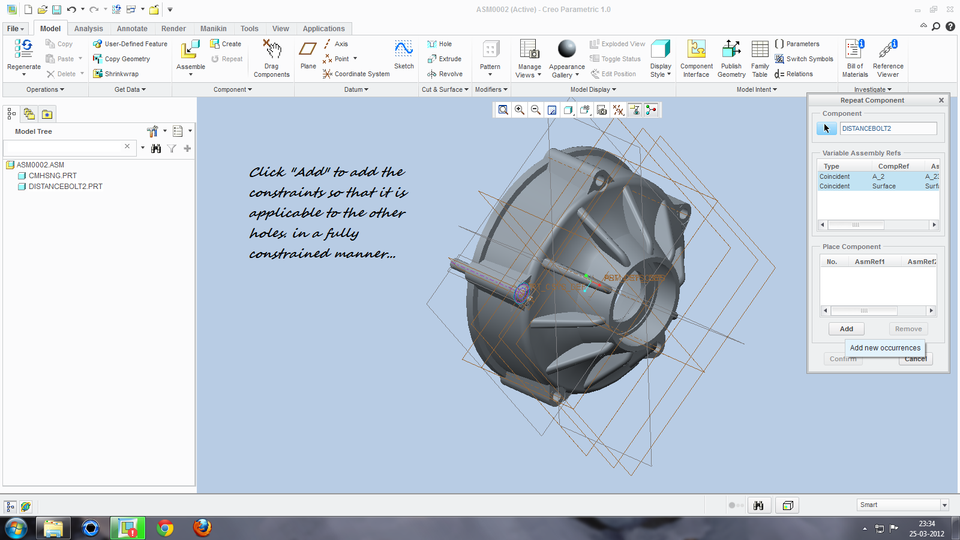

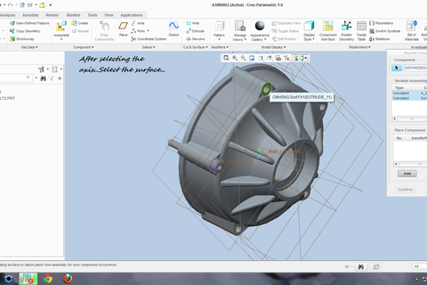

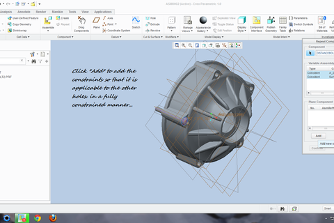

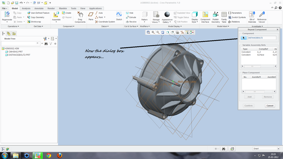

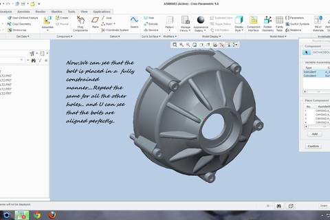

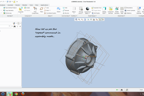

Here's a small tutorial on how to use the repeat command in proEngineer assembly mode..If we want to use a bolt of same dimension @ different locations (with same constraints)..then this command proves to be very useful..
Answered with a tutorial: https://grabcad.com/tutorials/repeat-command-in-assembly-mode-of-proengineer
Another way to "repeat" would be to copy and paste. After assembling your bolt, click the component to highlight it and hit ctrl-c and then ctrl-v and then select your datums in the same order you did your first bolt. This also works with holes. Super fast!
