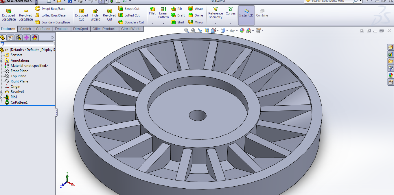

Rib angle in SolidWorks

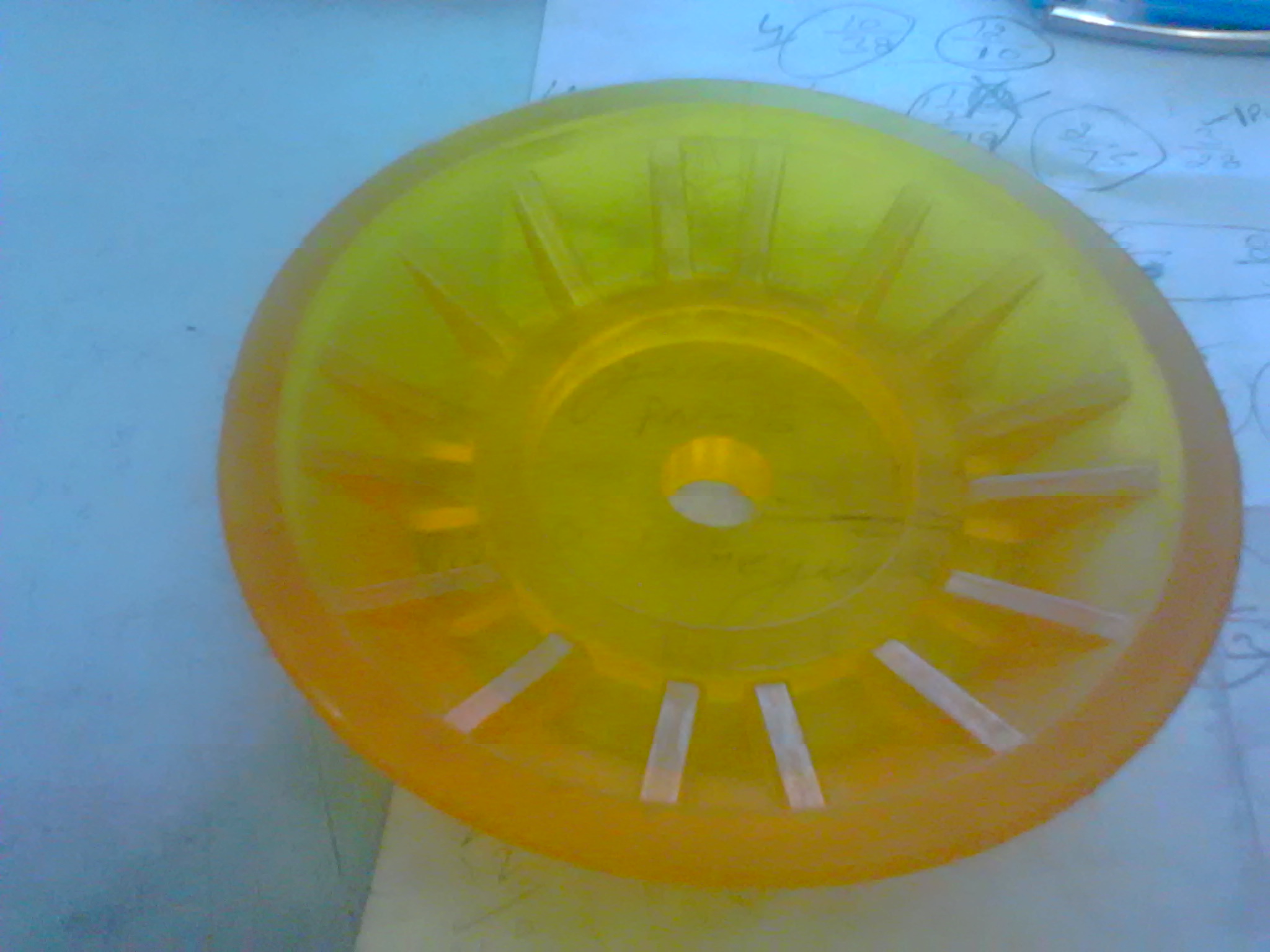

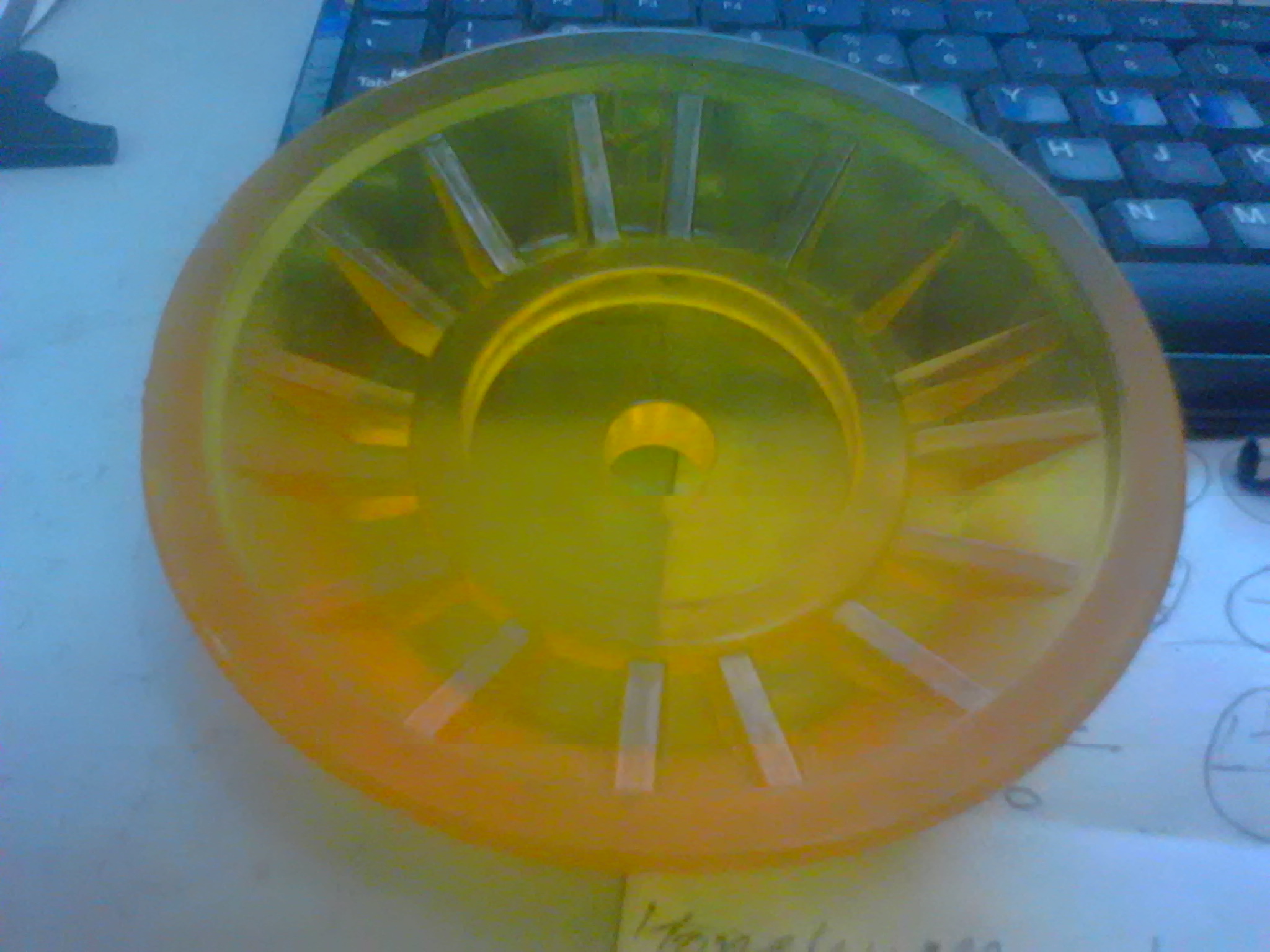

How to make the ribs on the angle as given in the pic. I have to make the ribs on the part attached below.

Hi !
You can sketch a line on the top plan of your part from inner cylinder to the next wall, then use rib tool to create one rib, adjust thickness, draft if required, repeat rib function to obtain the others. While hoping this willhelp.
Hi RAHUL,
I have tried to estimate angle values of the two series of ribs. Contrstruction is the same way as before. Rollback feature manager and arrange angle values and other parameters to your convenience. Regards.
i hope this helps
Answered with a tutorial: https://grabcad.com/tutorials/rib-angle-in-solidworks--1
