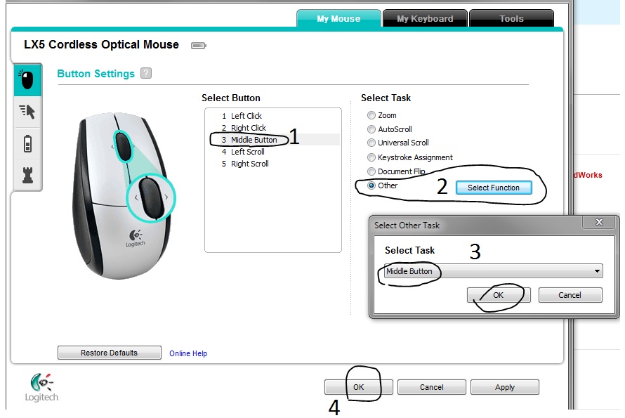

Hello, I am trying to find a setting for enabling third mouse button model rotate in SolidWorks. Am I missing something, or is it a logitech mouseware issue? Thanks!
Its not a Solidworks setting. If you haven’t installed the Logitech Setpoint software, install it. Right click on the icon on the bottom right. Then go into the settings and you will see where you can set the wheel button to be a "middle button" (see pic)
