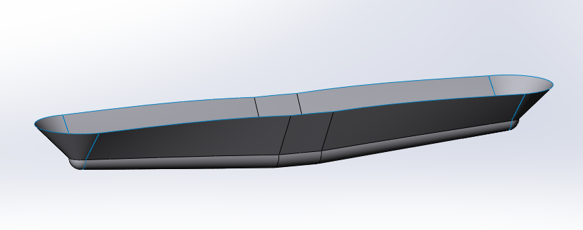

Hi, everyone! Please, tell me how can i do next. When i create this part with Lofted boss

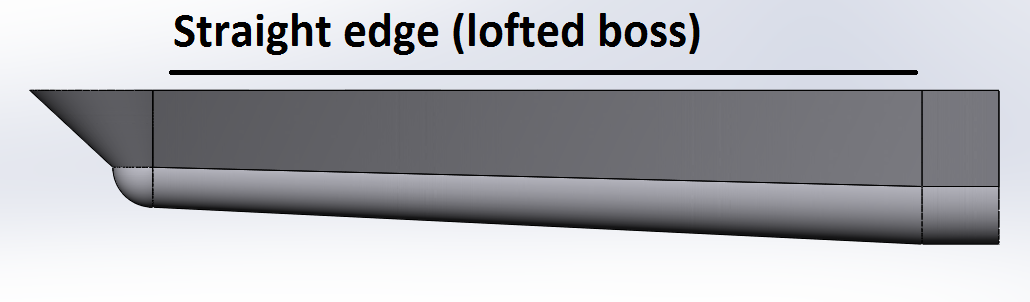

all edges are correct. But i need to create this part with surface method (lofted surface), and when i do it some edges are curve (must be straight). And i don't understand how can i do it.
you could take your correct solid body and convert the faces to surfaces and then delete your solid.
