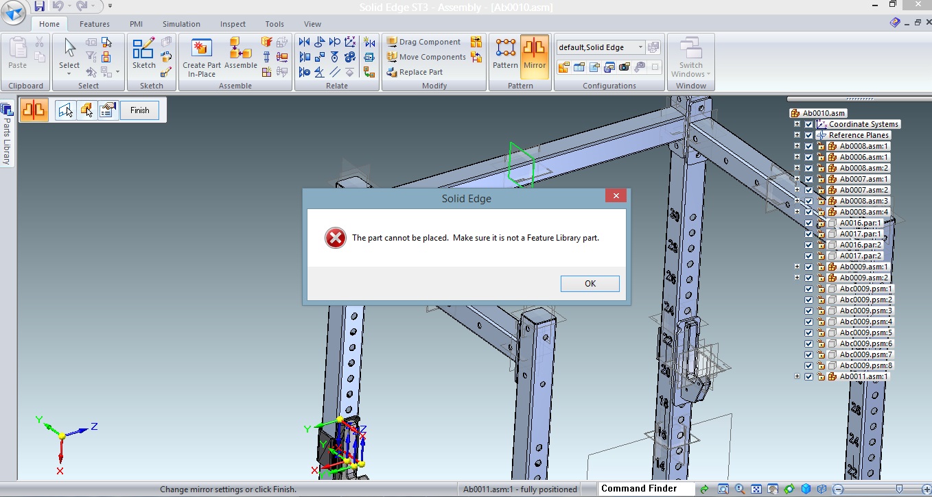

Hello,
suddenly when i do the steps for making mirror it doesn't show in the last step the mirror tab and when i go to close it a message appears ! How i can fix that ?
Added images

    Hello my friend.
    After you open de assembler file you need to be sure that the complete assembler is activated.
    How you do that? step in the top left Ab 00110.asm and click right, find the command activate and after activate all treat to make a mirror again.
    If that no work you need to be sure that the file. part you want to mirror it´s located in a correct folder.
    Please let me know if the problem was corrected.
    Regards
