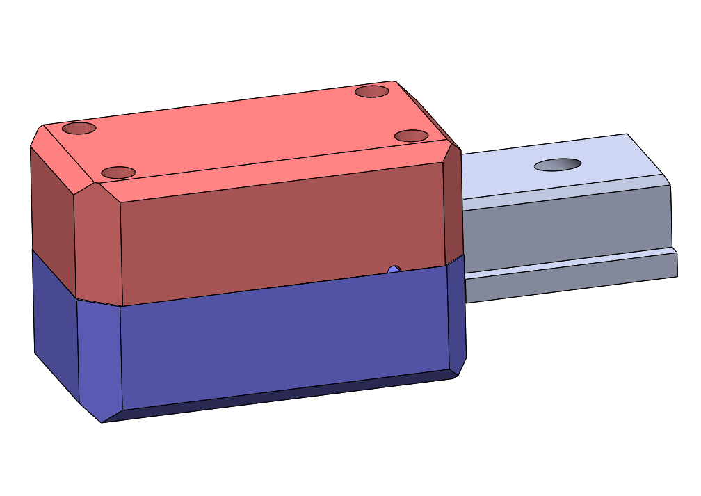

1. Hide all of the unneeded parts in the assembly. Focus on a single core/cavity.
1b. Save that assembly file as a part file (file - save as - part)
2. Open the newly saved part file on its own

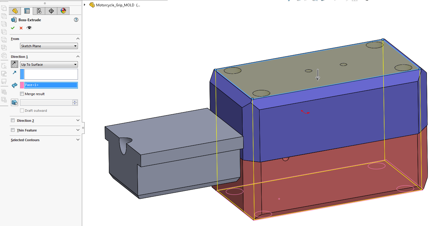

2b. Create a simple sketch and extrusion which will fill and overlap the cavity you are trying to measure. When extruding this sketch DO NOT merge it with the existing bodies.

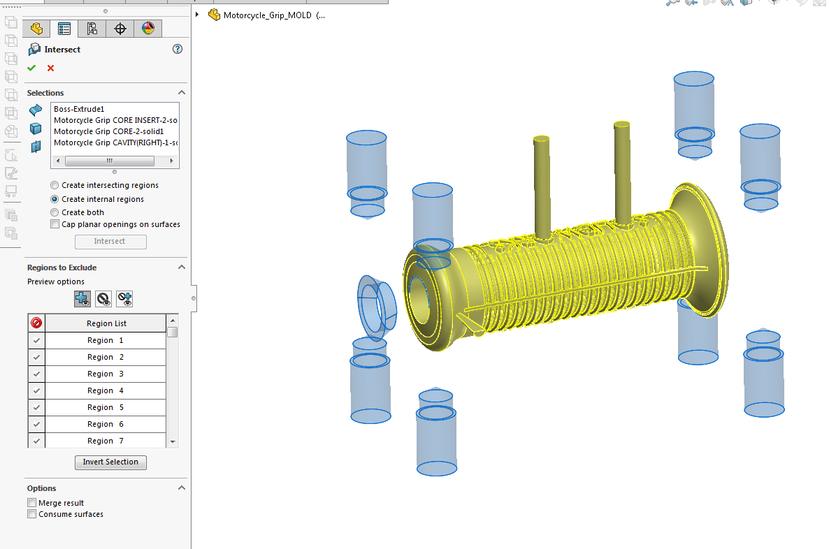

3. Use the rather confusing Intersection command (Insert - Features - Intersect) to trim away the intersecting portions of the step 2 extrusion.

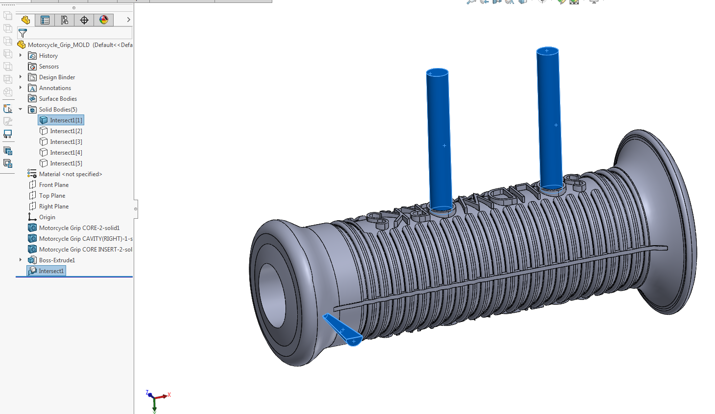

4. From the resulting body, trim/delete away the gates/runners/vents and other unwanted faces.

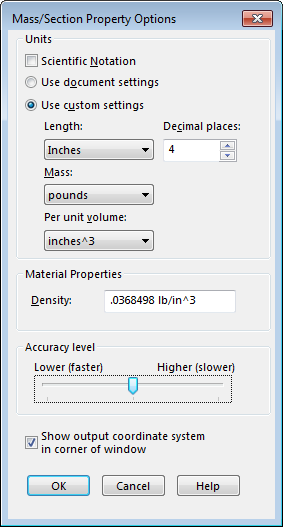

5. Edit the material properties and set the material density.
Now this is the tricky part:
I think if you use the measure tool at this point to measure the mass in grams, you'll have the correct answer.
But, the problem states the material has a shrink rate of .5% The shrink should only affect the part volume, not the mass, but you could play it safe and apply a scale factor of .5% (Insert - Feature - Scale) to the part and remeasure the mass. Provide this answer as a second answer and state you were unsure of it affecting the mass. Teachers (sometimes) love it when students ask questions, and consider the problem.
