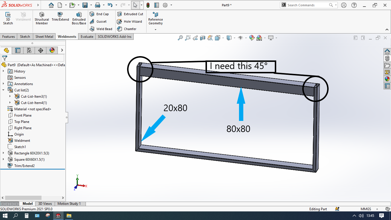

Hi engineers!
My problem is in the category "Weldments"!
What is the easiest way to put two types of pipes in one group and they are connected at an angle of 45 degrees?
See the attachment!
Thank you!

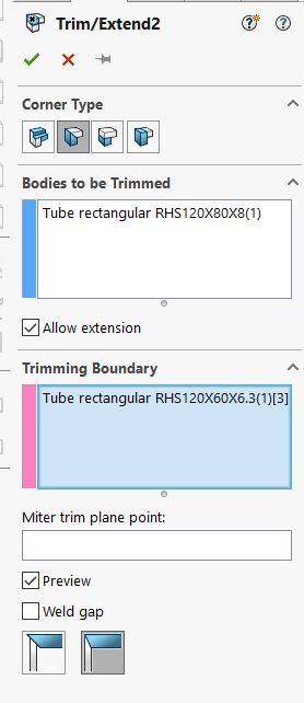

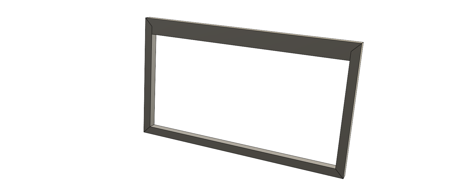

it should. see attached file (sw2021)
if you can't open it. send me your file i will do the corners and send you an step file
If it is going to be welded, this maybe a cleaner design and a true 45 degrees.
have you tried trim/extend feature?
