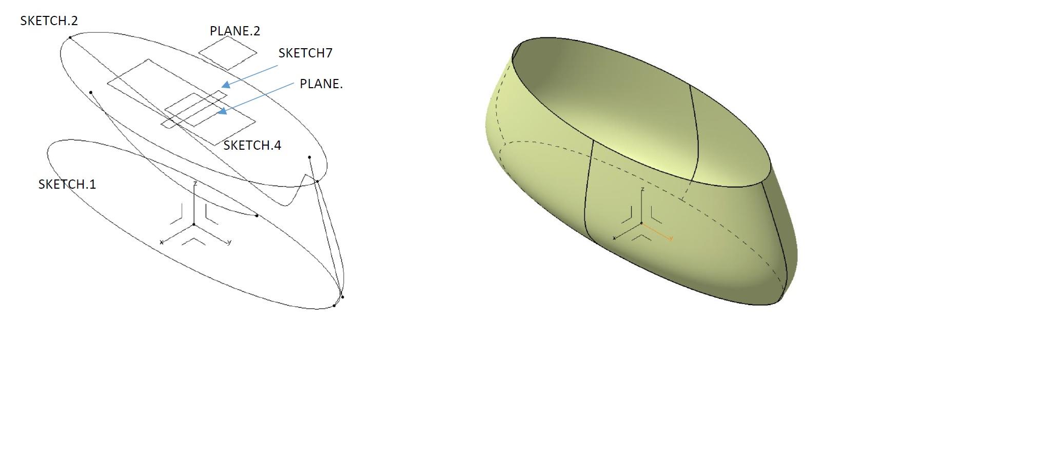

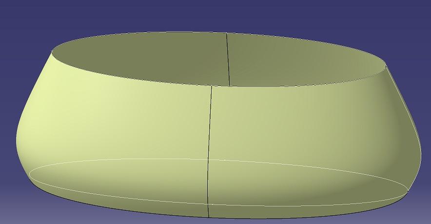

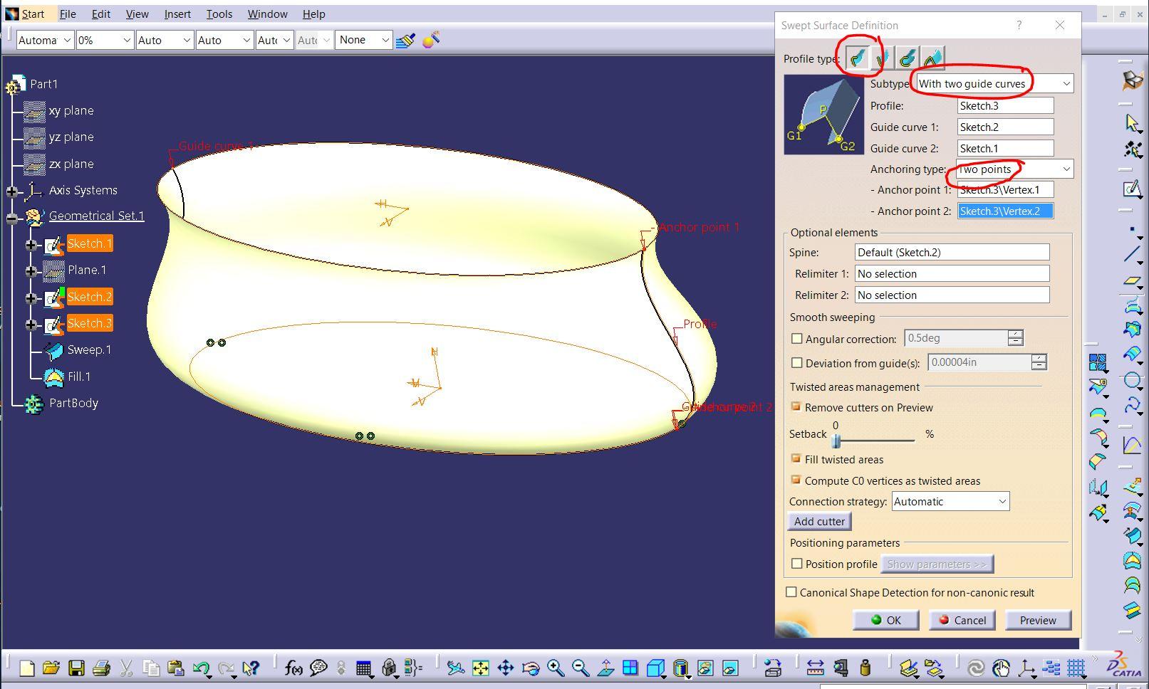

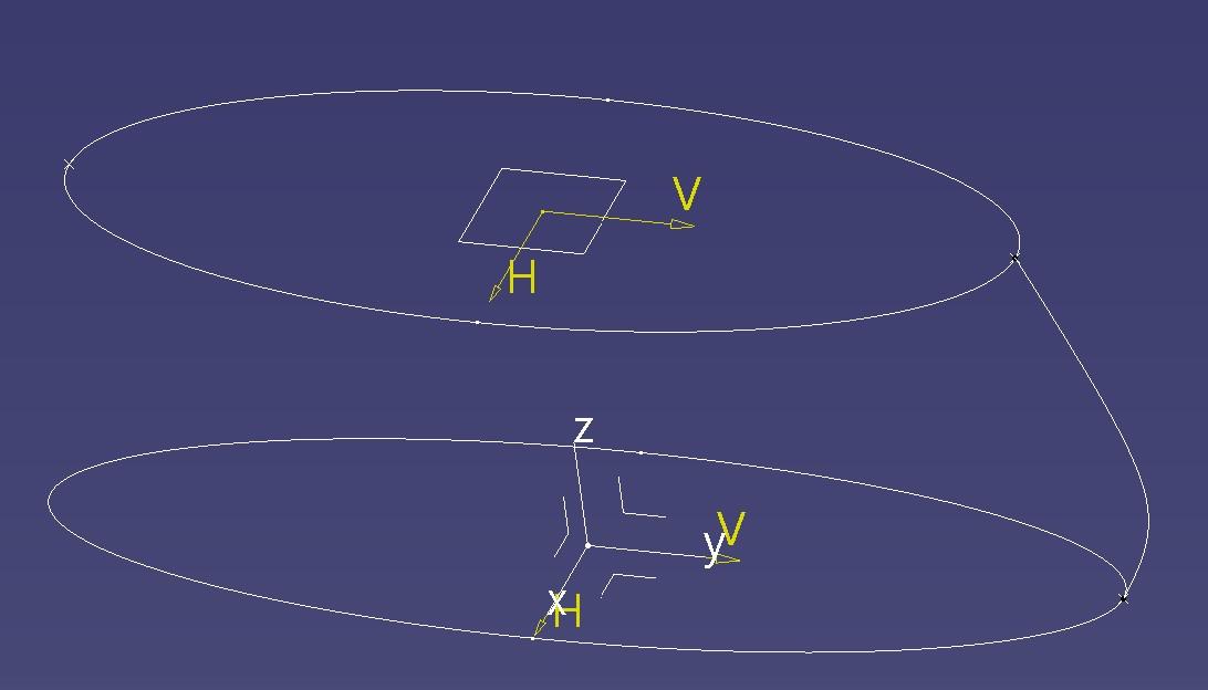

Surfacing using catia? S K 5 Feb, 2022 04:17 AM How can I surface the following wireframe? I tried to use Fill and Sweep operations with no success. Please help. Sweep.jpg M.jpg Screenshot 2022-02-04 231510.jpg Accepted answer Jack K Answered on 6 Feb, 2022 03:46 AM here's how I did it: SWEEP.JPG 1 Other answer Jack K Answered on 5 Feb, 2022 06:02 PM A Sweep should work. Did you use the top and bottom curves as Guides? What did you use for the Spine? What happened when you tried to sweep it?
