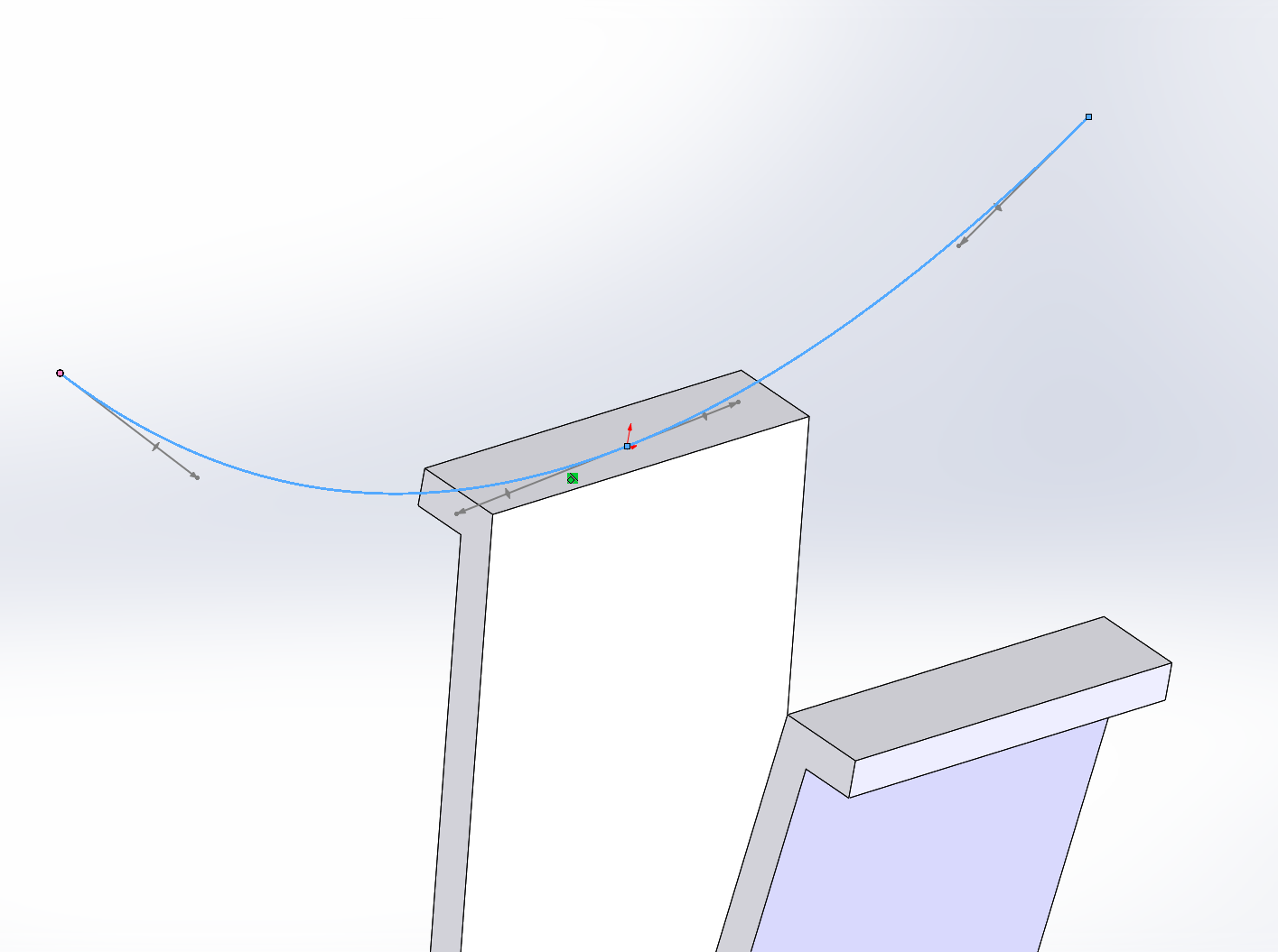

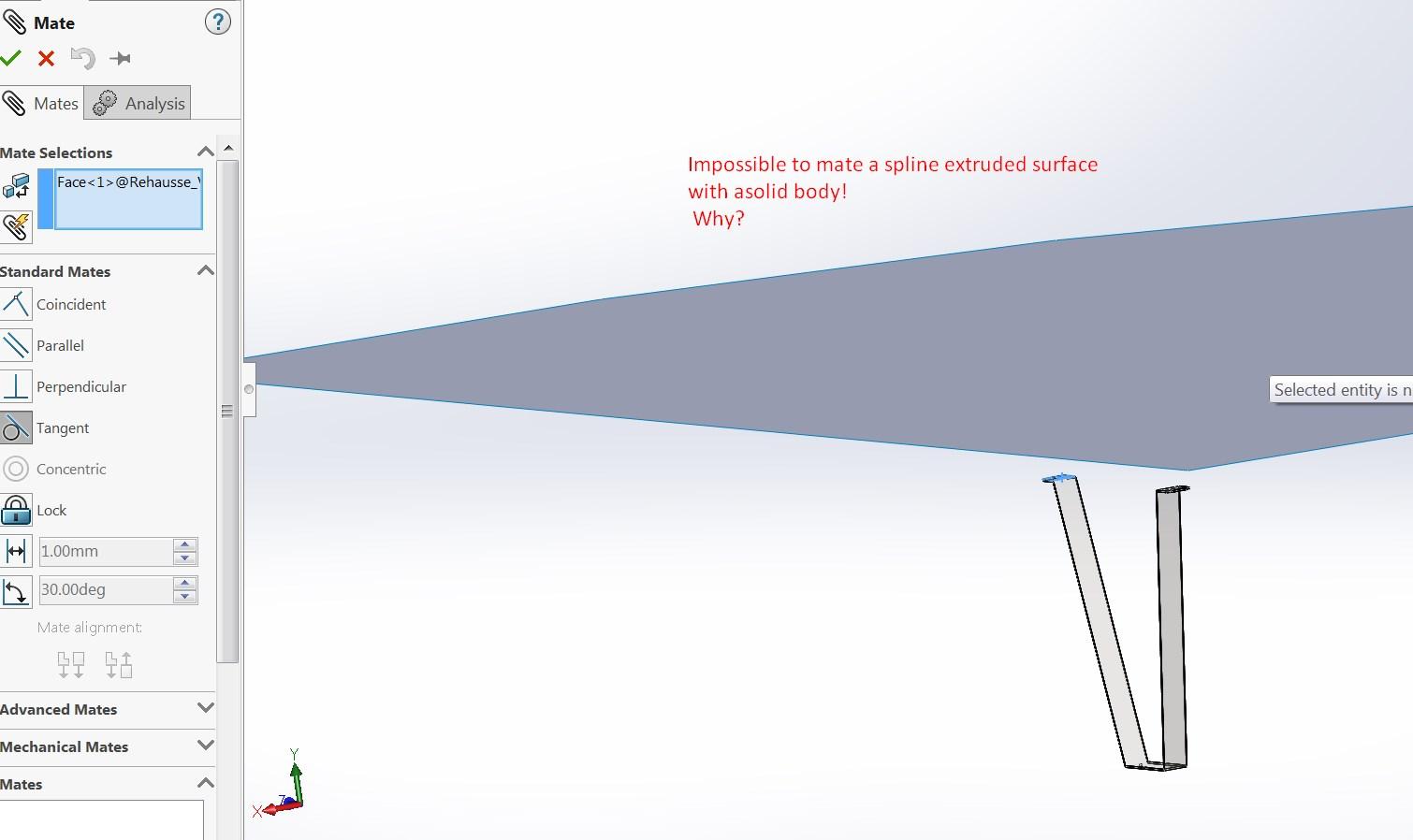

Tangent mate between surface and solid body failed. lololamoto 6 Sep, 2020 09:32 PM Hello, I need to apply a tangent mate between an extruded spline surface and a solid body, but it failed. How can I overpassed such limitation? Thanks SW Mate error.jpg Accepted answer J. Riend Answered on 7 Sep, 2020 01:46 AM You can mate the surface spline sketch tangent to the solid parts surface. Tangent Spline Sketch.PNG 0 Other answers
