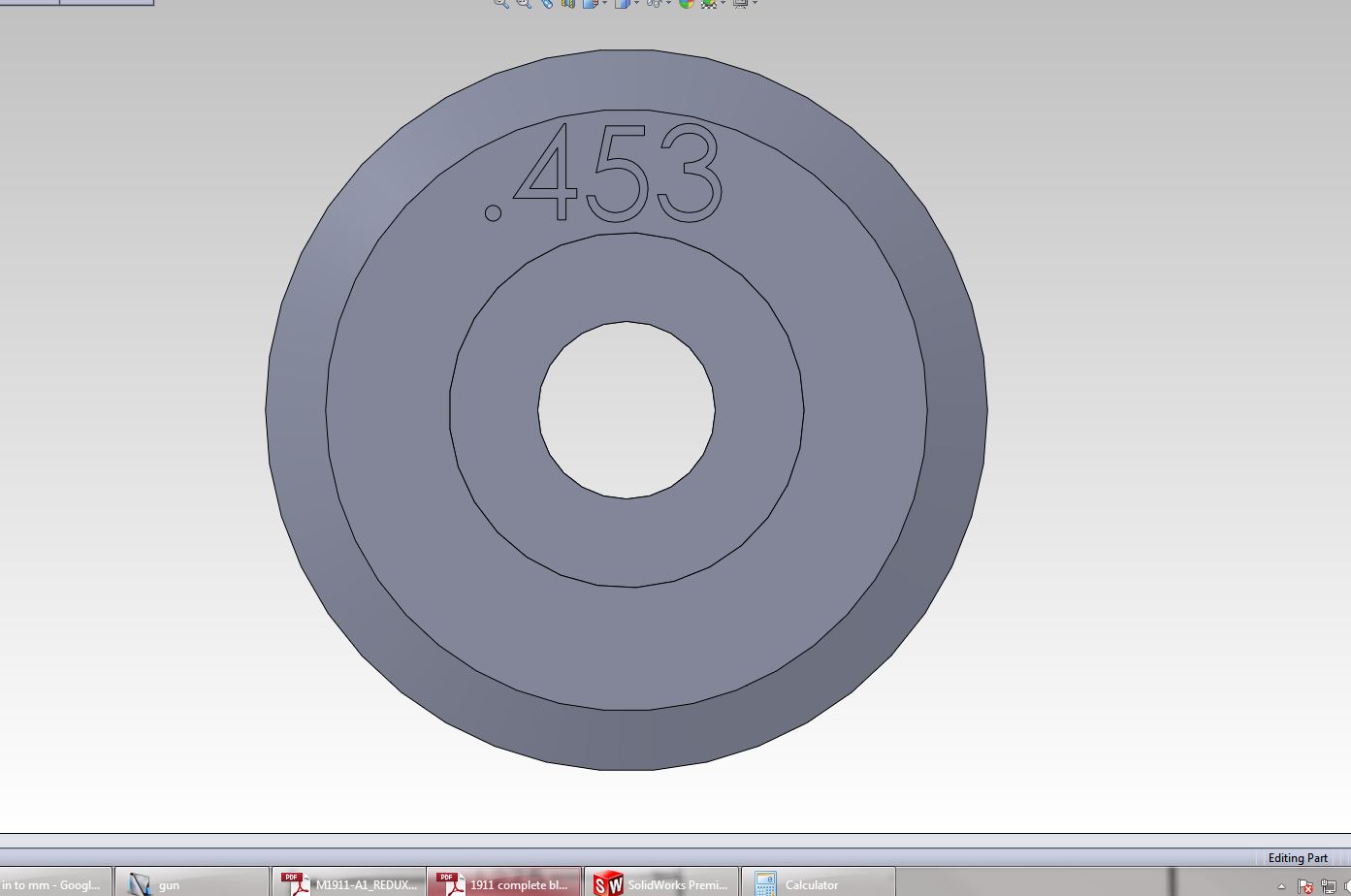

Tex array circular or path Solidworks 2ea76538 4 May, 2013 02:56 AM I never worked with the text feature in solidworks. How can I get a text to array around a cylinder or follow a curve or path? Capture.JPG 2 Answer john fall Answered on 4 May, 2013 09:29 AM easy draw a rad for txt position then when you insert txt click on rad in curve box, see attached text.SLDPRT 2ea76538 Answered on 4 May, 2013 07:39 PM thanx mate that did the trick
