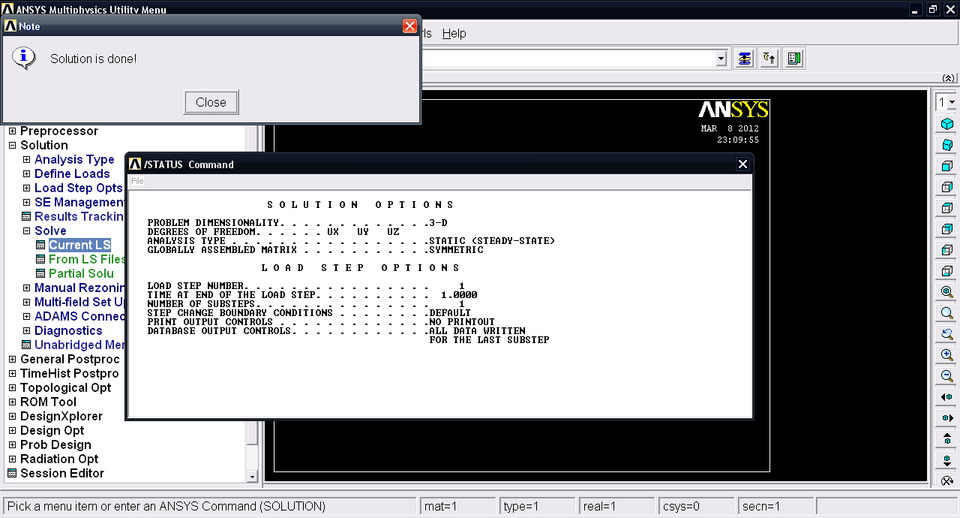

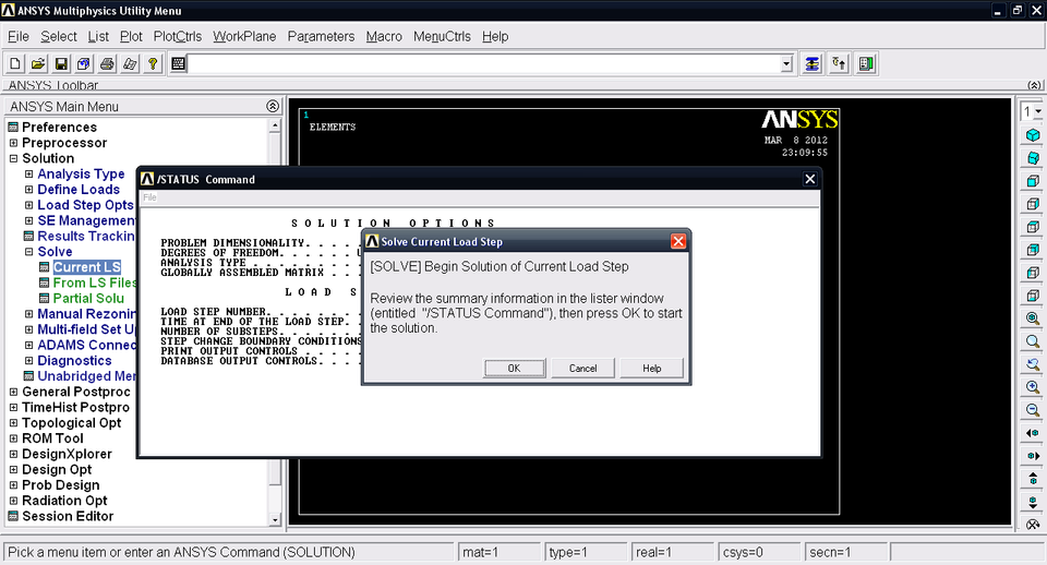

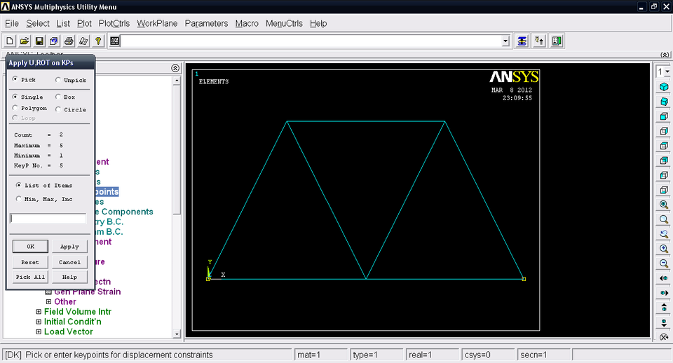

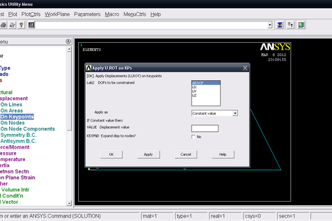

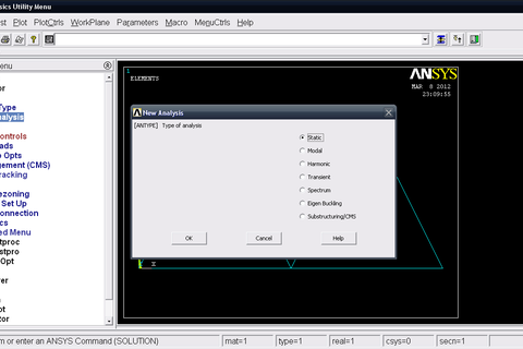

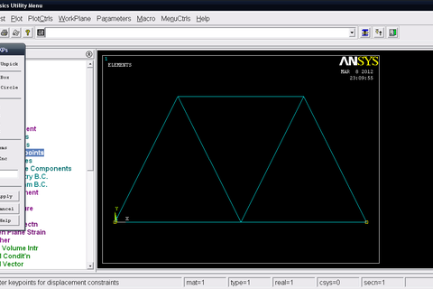

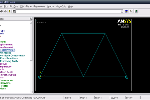

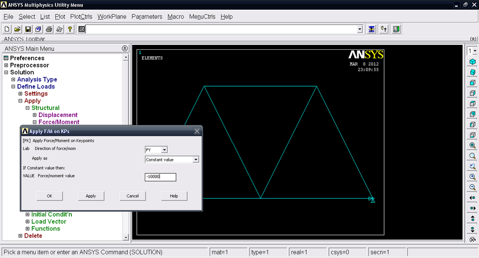

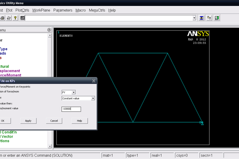

2. Solution: assigning loads, constraints and solving;

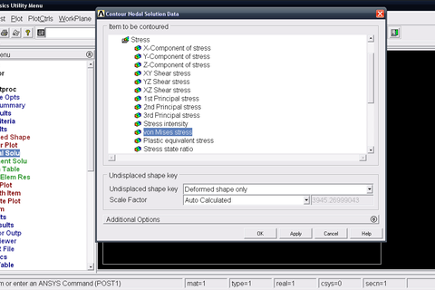

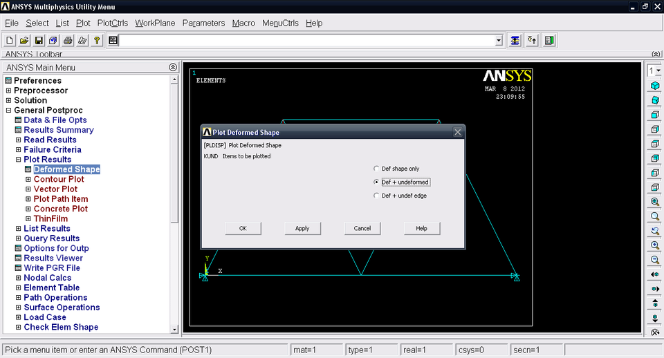

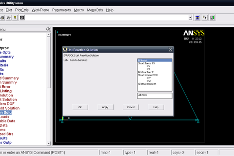

3. Postprocessing:
- Lists of nodal displacements
- Element forces and moments
- Deflection plots
- Stress contour diagrams

Answered with a tutorial: https://grabcad.com/tutorials/tutorial-2d-truss-analysis-in-mechanical-apdl-ansys-part-2
