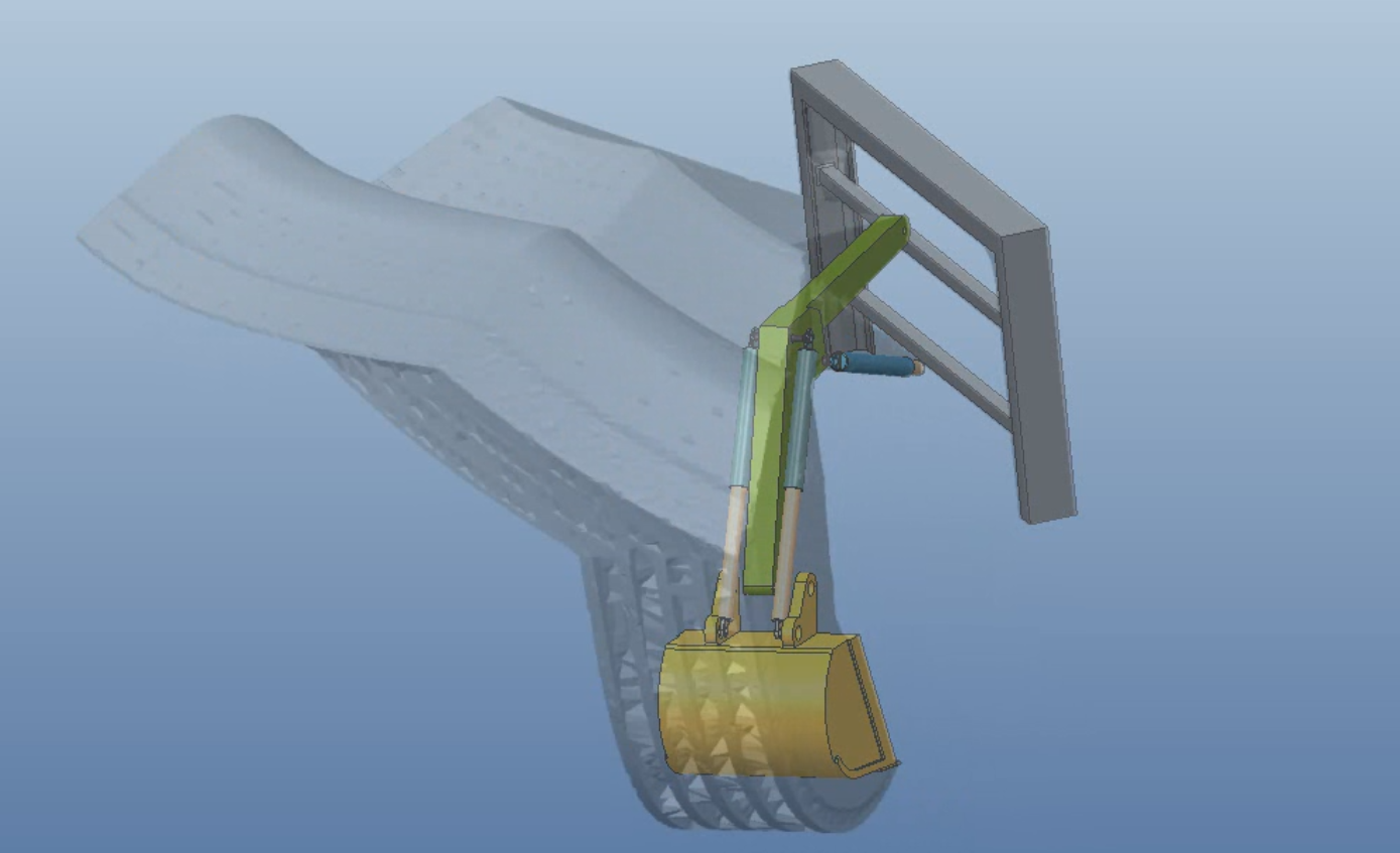

Tutorial: How to create motion envelope model with PTC Creo Parametric from mechanism
Mechanism Design with PTC Creo Parametric allows you to extend your design with cams, slot followers, and gears. When you are ready to analyze the movement, you can
observe and record the analysis, or measure quantities such as positions, velocities,
accelerations, or forces, and graph the measurement. You can also create trace
curves and motion envelopes that represent the motion physically.
Here is the short tutorial and final video for you :o)
Here is the final animation: http://youtu.be/qZCStk9TqV4
Download data here: Tutorial: How to create motion envelope model with PTC Creo Parametric from mechanism

Do you need to create motion envelope part - here is the short tutorial for you: How you can create motion envelope model with PTC Creo Parametric from mechanism:
Answered with a tutorial: https://grabcad.com/tutorials/tutorial-how-to-create-motion-envelope-model-with-ptc-creo-parametric-from-mechanism
