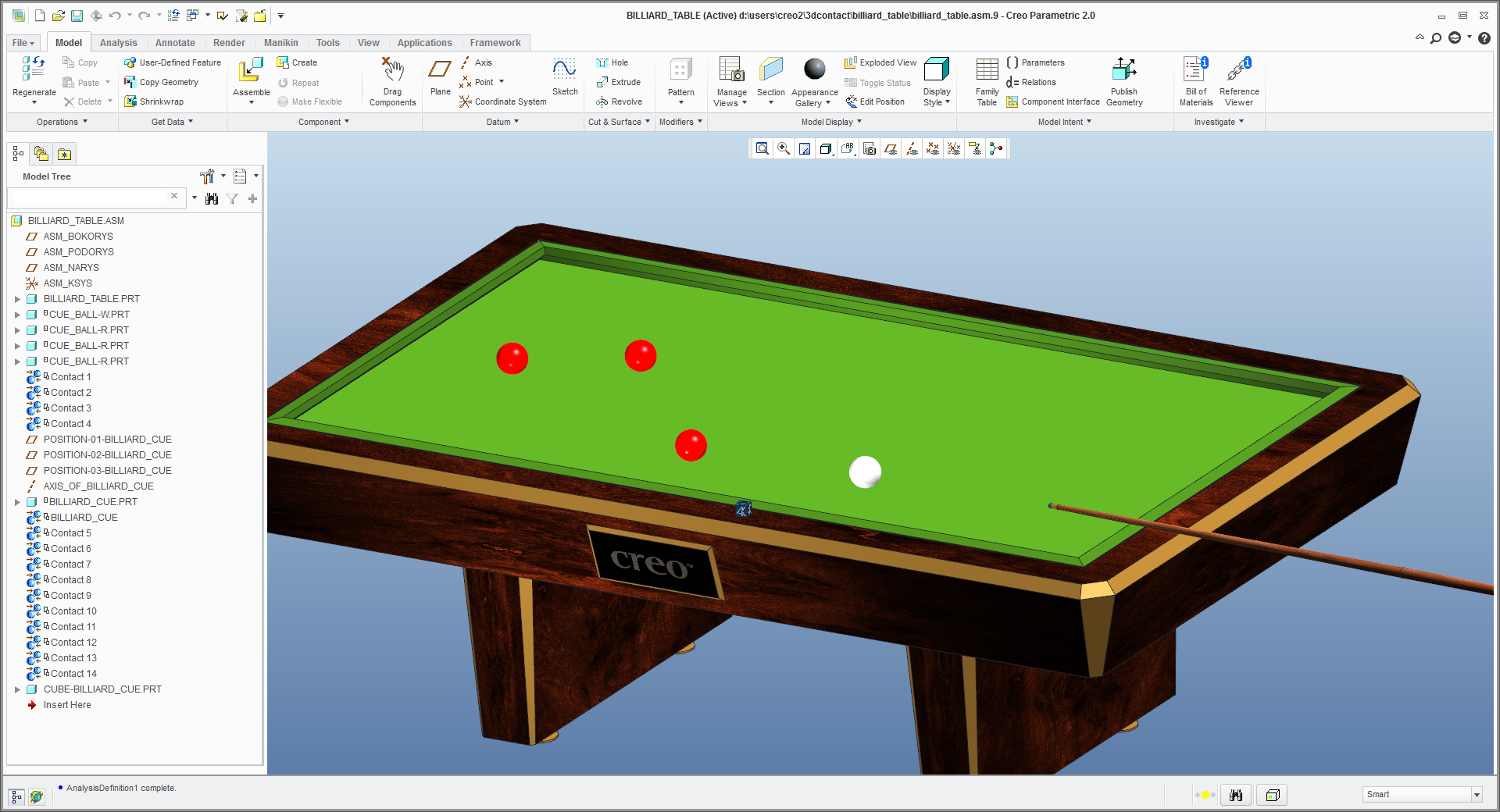

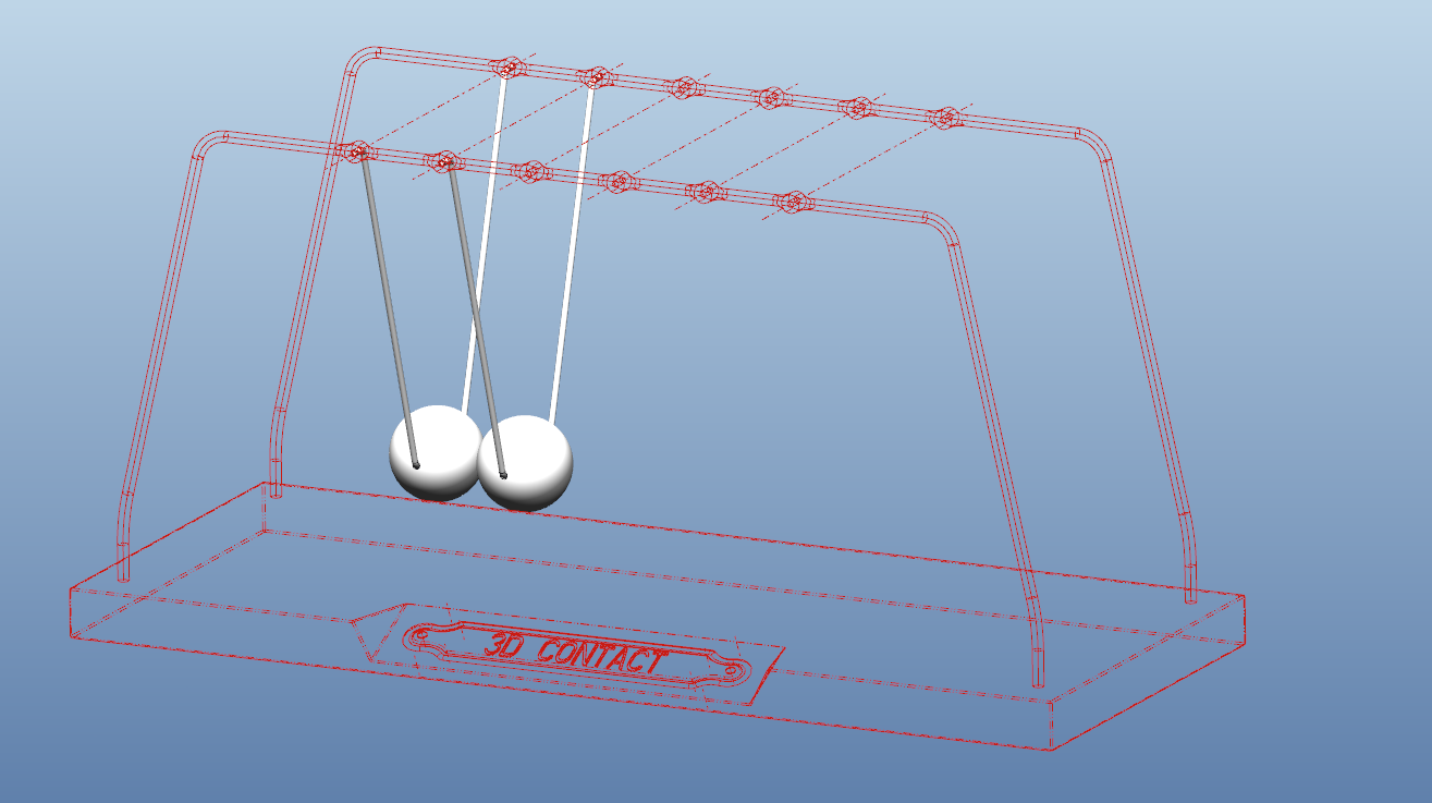

Tutorial: How to create 3D contact with PTC Creo Parametric
Do you need to create and animate Newton's Cradle or Carambol's shots - here is the short tutorial for you
... you can Download 3D data (Carambol_shots-creo2.zip) and investigate mechanism :) or you can Download STEP/IGES file and try to render your own images
Regards,
Vladimir
Download data here: Tutorial: How to create 3D contact with PTC Creo Parametric
3 Answers
Here is the short tutorial; How to create 3D contact with PTC Creo Parametric
Answered with a tutorial: https://grabcad.com/tutorials/tutorial-how-to-create-3d-contact-with-ptc-creo-parametric
