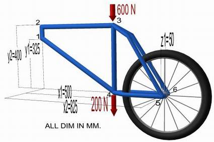

Tutorial18 ::bicycle frame analysis in ansys
This is (http://www.mece.ualberta.ca/tutorials/ansys/BT/Bike/Bike.html) Alberta university tutorial for Ansys 9, I have just modified it for new version( ansys 15)
3 Answers
Second section, first do first section
Answered with a tutorial: https://grabcad.com/tutorials/bicycle-frame-analysis-in-ansys--1
you can find this tutorial in Alberta university site but they have done it by ansys 9 and I have just modified it for new version. please pay attention to the red line and Please accept my apologies for poor English.
