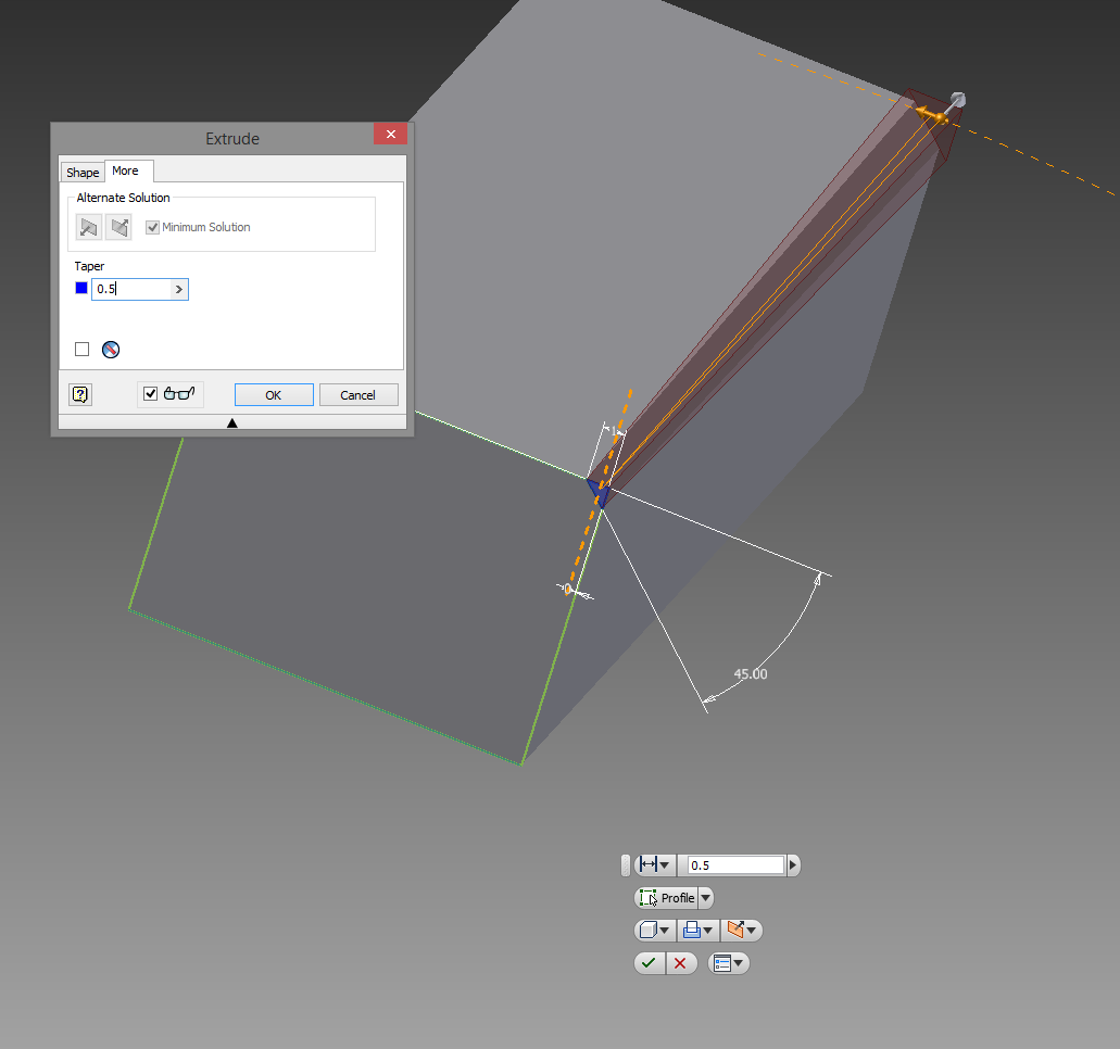

create the profile on the top of the edge use cut extrude to extrude it over the edge go in the extrude command to taper in the more tab
