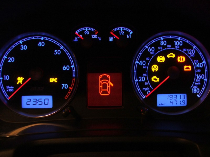

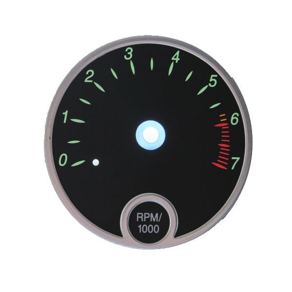

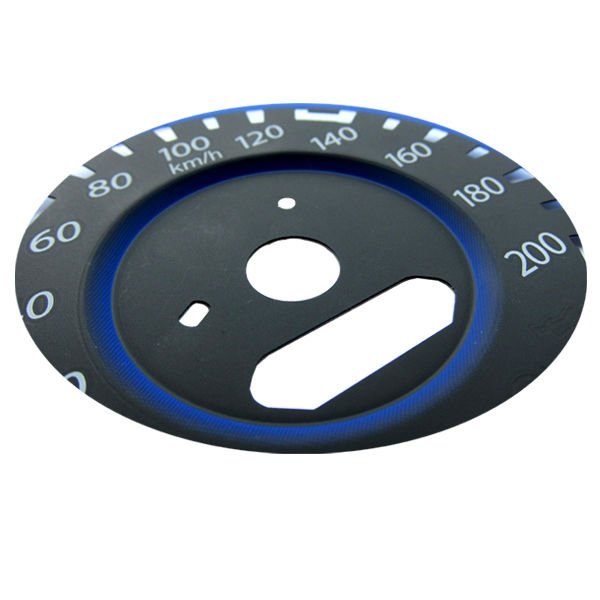

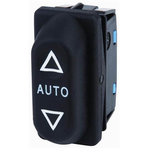

what is the name of this Technique?
what is the name of the Technique which is use in auto dashboard or car windows switch.
i mean the paint-technique
please check the photos
thanks
Pad Printing
Hot Stamping
Foil Stamping
Screen Printing
Industrial Digital Ink Jet Printing
Heat Transfer Decals
They all differ in application, for example Gloss Finishes, Multiple Colours, Measurable Units, Surface Finish and Wear Resistance are factors that will influence the appropriate technique or process.
