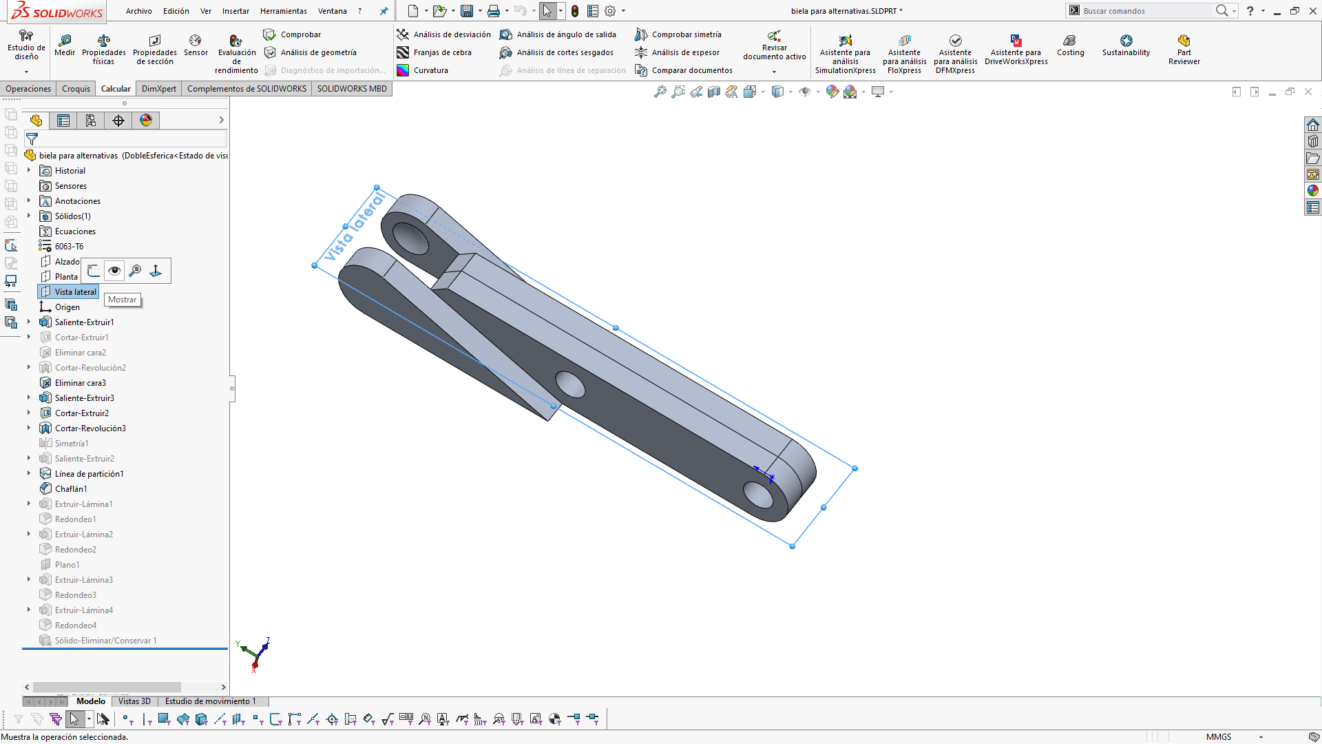

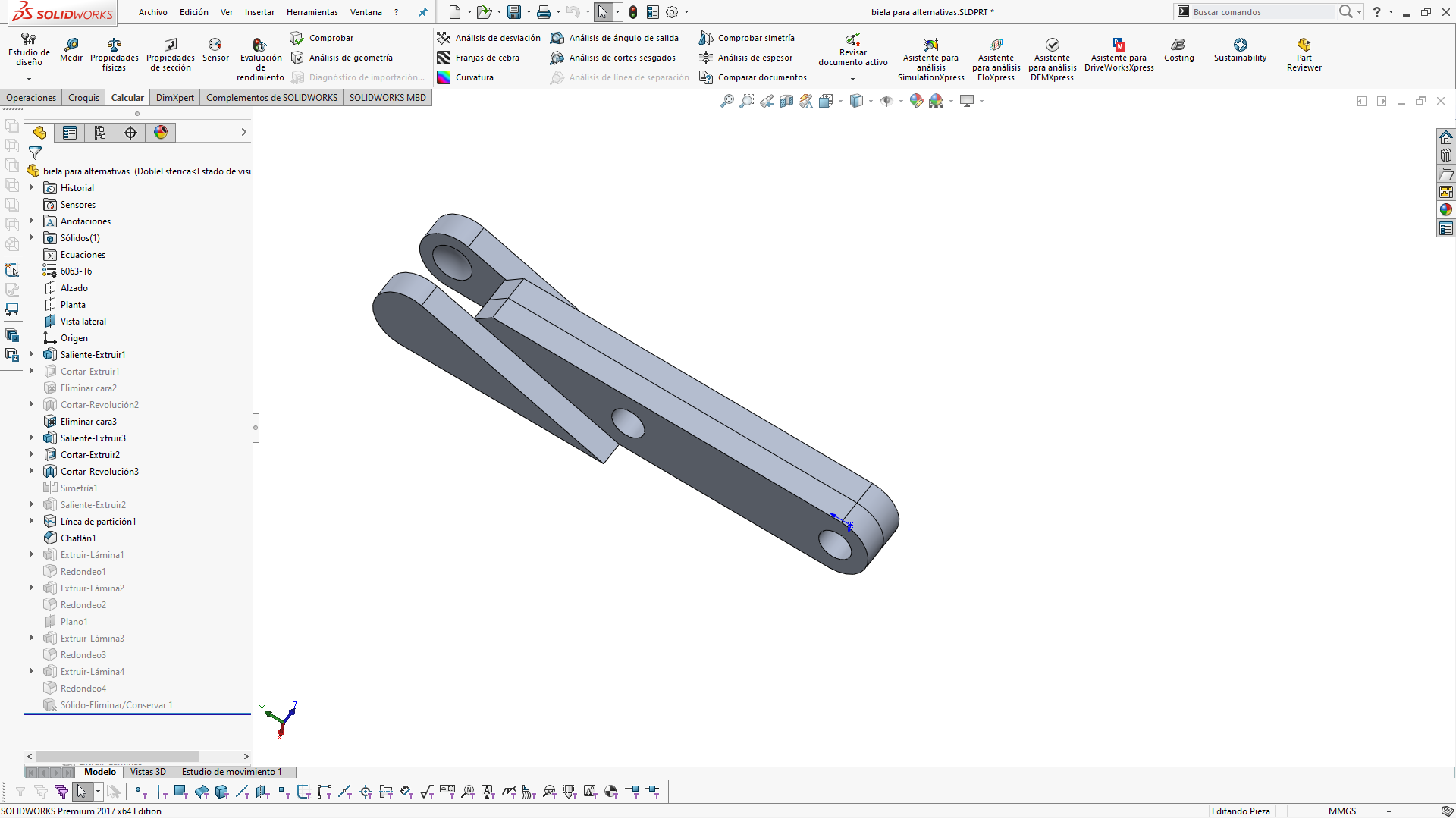

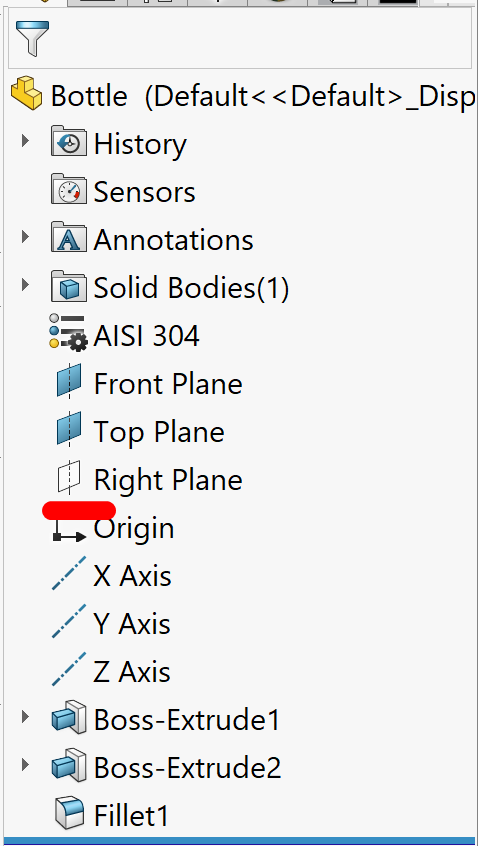

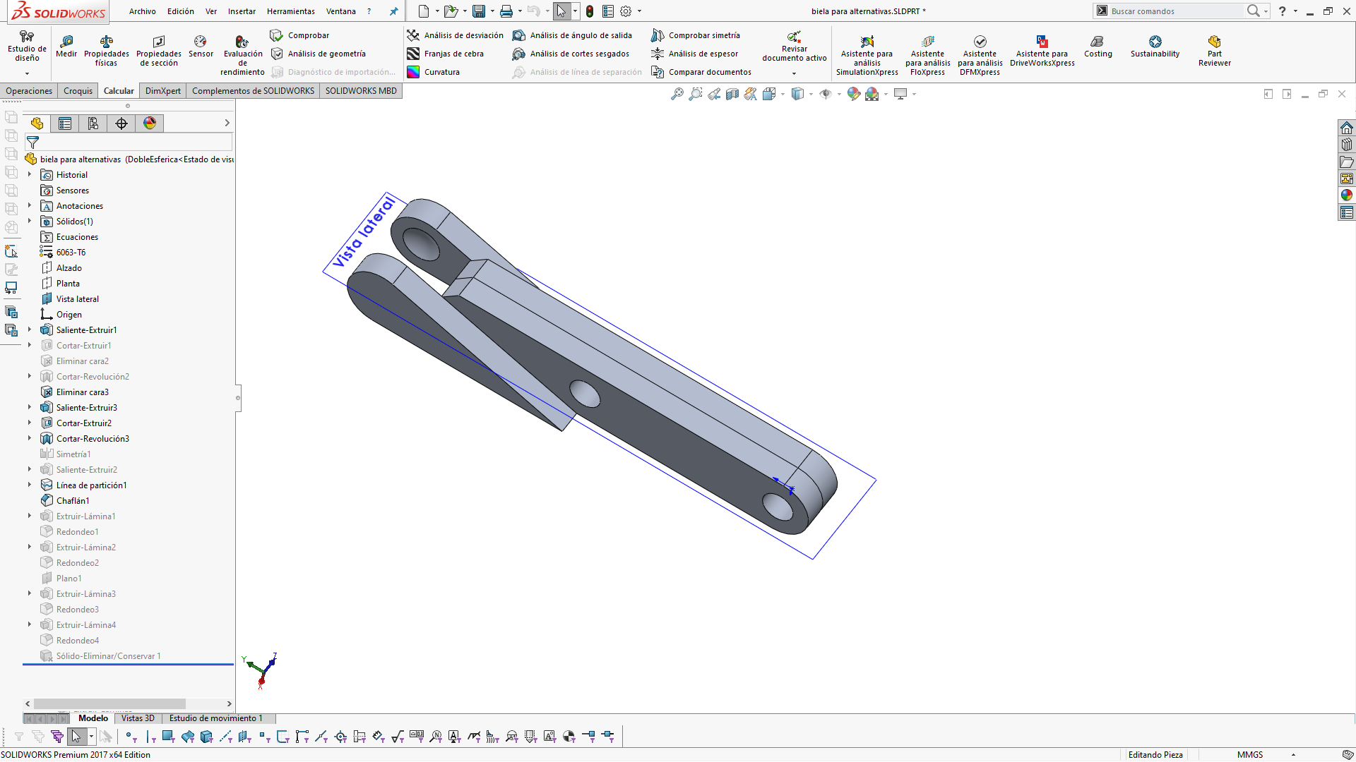

A plane (axis, origin, etc.) can be hidden if it is visually distracting when all other planes are visible. If it is visible, it can still be globally hidden from the "Hide/Show" menu for all components of that type.

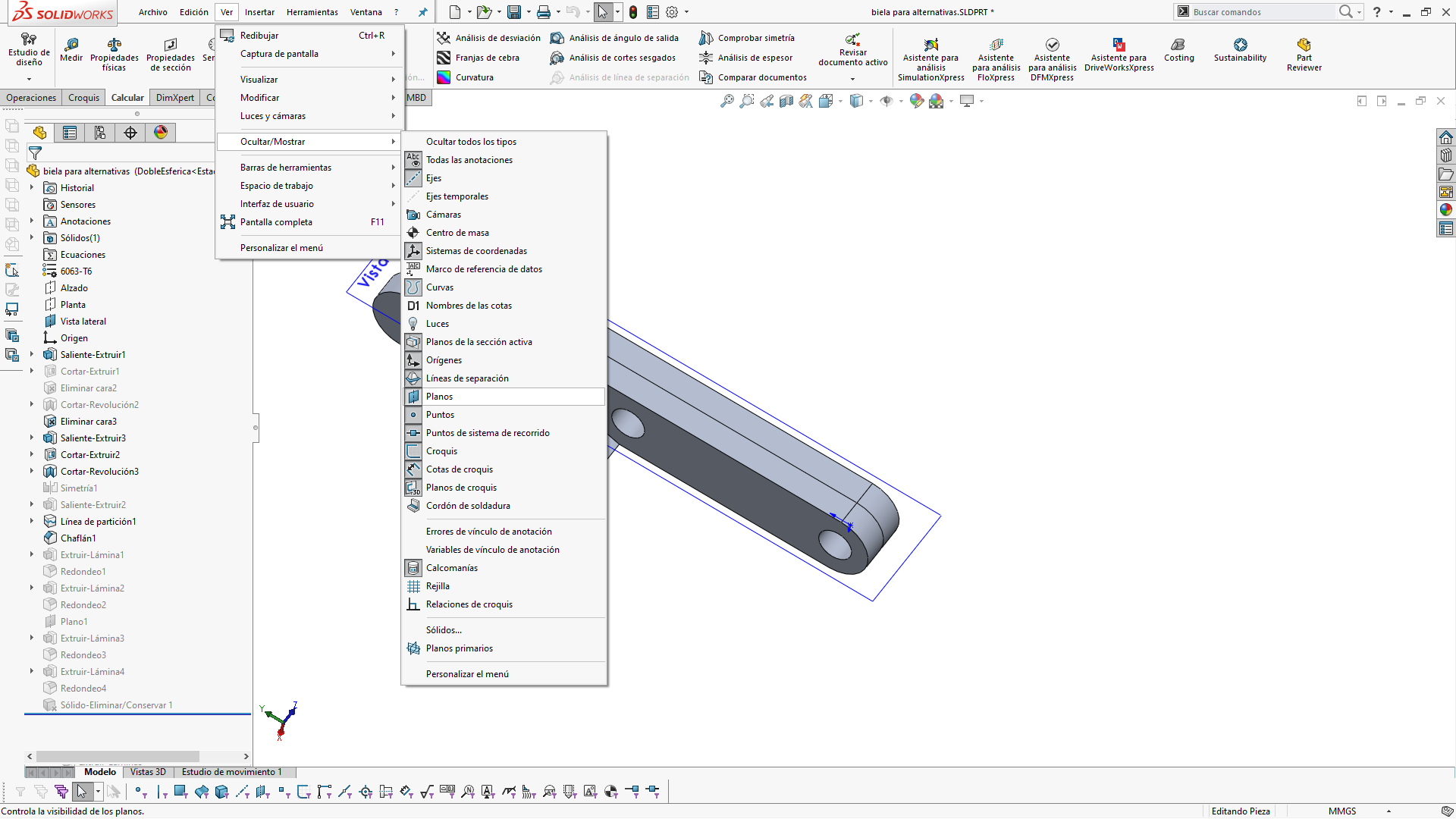

There are two ways of working: the first is to hide in a longer and more specific way (certain plane, axis, origin, etc.); the second is a quick way to show or hide all those types of items, as long as they haven't been hidden individually.
