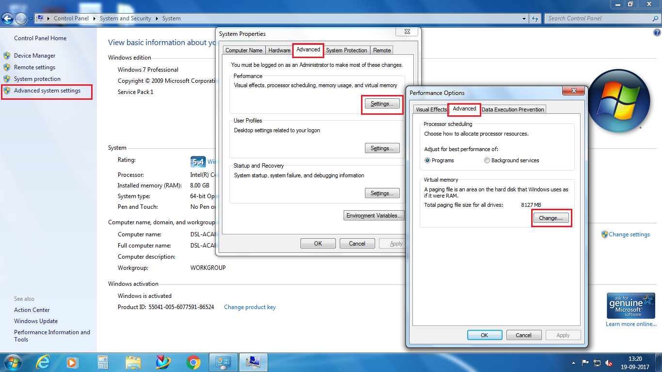

change the paging size for all drive. you can increases to 4 GB, 8 GB or 16 GB also as per your vacant space
first you try by Increases your systems virtual memory, if your problem didn't resolve then u have to upgrade your graphics card.
step:-
My computer> right click> property> on left side panal "Advance system setting"> (one popup windows come)> click on "Advance"> performance> setting> advance> virtual memmory> click on Chance.
