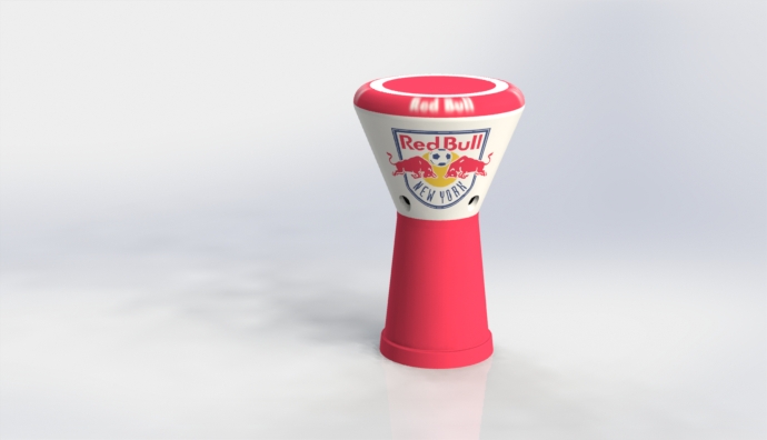

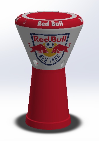

Hello everyone ,
please see the attached photos
that's my problem
when I put appearance on the ring (an image) it appears good in the working space of SolidWorks
but it appears very bad in rendering
can anyone please tell me how to fix this problem ?
it's not the first time for me to have this problem
Thanks
Best Regards ,
Farid
I believe this is caused by the way the texture is mapped to the cylindrical faces. Is the red bull logo in white background and the distorted letters one picture? If yes, try splitting the texture in 2 parts and apply them separately. You could also try using them as decals, not textures materials if all else fails...
