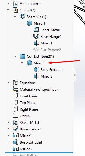

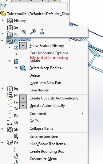

Ihello, i'm trying to assign different material in multiple body part using SW2019.
The problem is that the material is not present on the contextual menu.
How can I get the material on this menu (all tutorial screenshot got this material in contextual menu, but not mine).

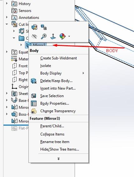

You have to right-click on the body itself, not the folder it's in...
It doesn't works, none of the body work. It works if I don't have a cut list, but with a cut list, material is no more available.
Did you figure it out? I am having same problem with SW 2023. If I create new multibody part from scratch there is option available. On the part I am currently working on (made in version 2021) there is no option available. I am attaching the file with the material problem. Cheers!
