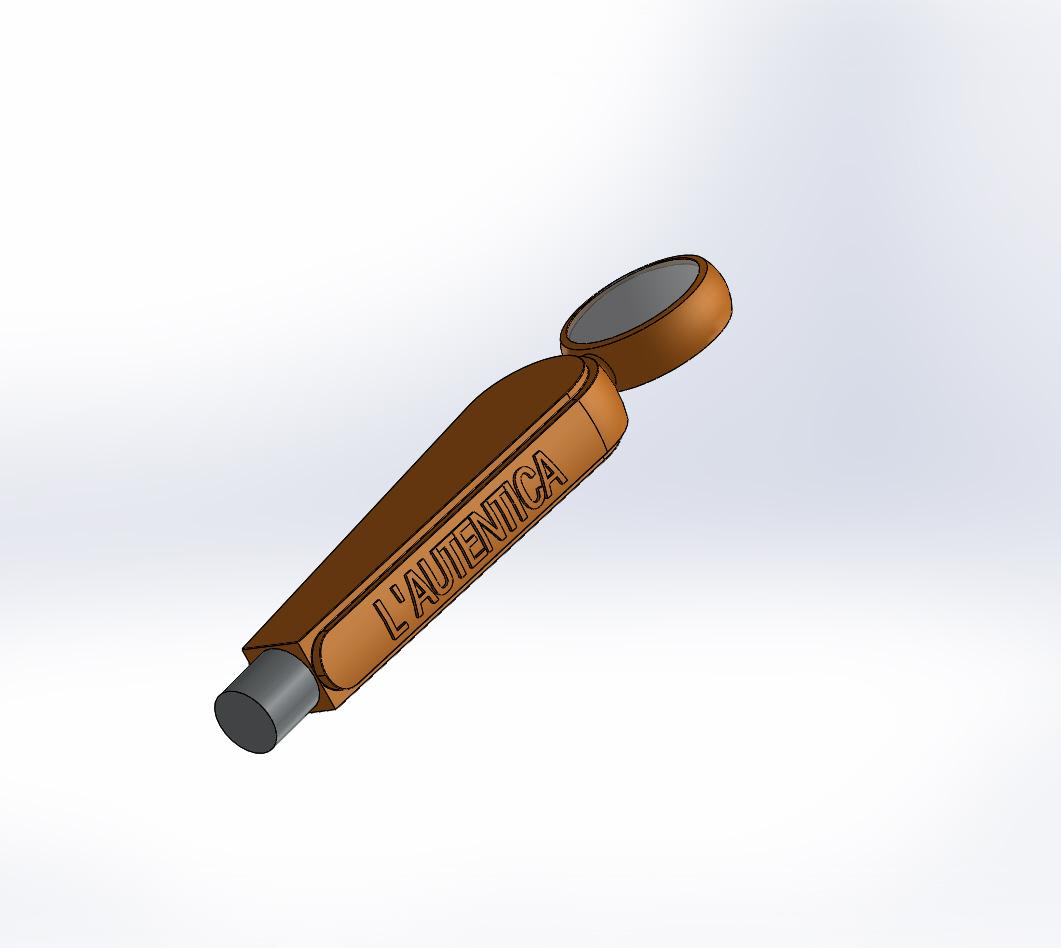

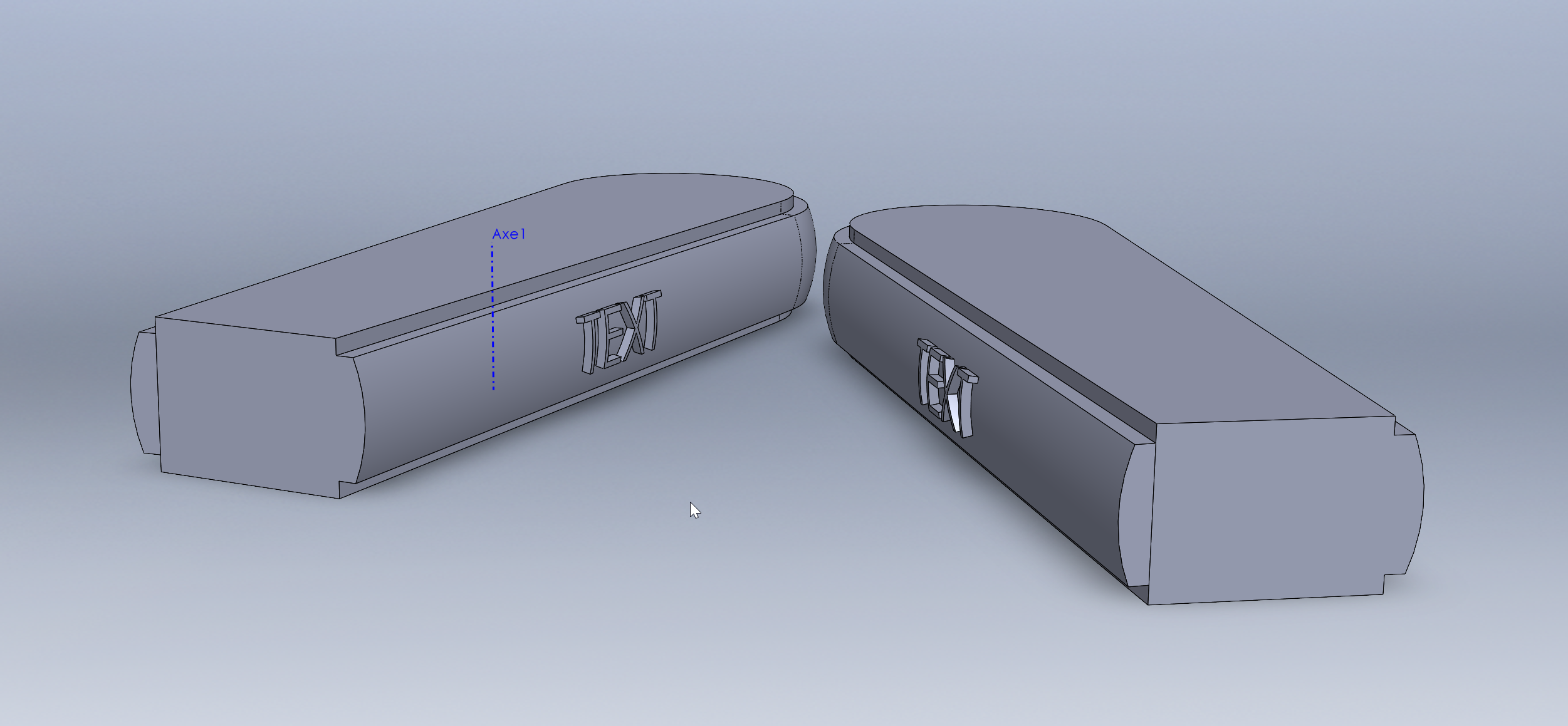

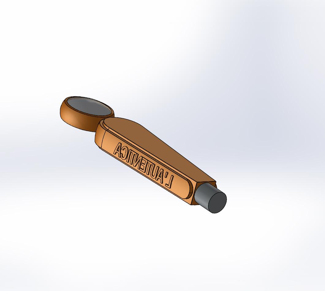

wrap text mirroring Stef Barneveld 25 Mar, 2021 09:05 AM can someone tell me how to mirror text on a curved surface? I now also get a mirrored text with the mirror feature taphandle rechts.JPG taphandle links.JPG 1 Answer Patrick Answered on 28 Mar, 2021 06:12 AM Hi Stef ! Mirroring doesn't works , you should use rotate parttern of the emboss feature arround mid axle , angle 180-angle part. It seems to work. screenshot.png
