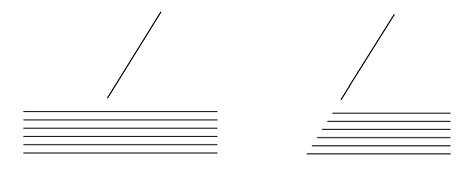

    3.)Take the edge out of Trim and Extend:-
    Using the system variable EDGEMODE can simplify your Trim and extend functionality. Did you know that you can TRIM and EXTEND to non-existent edges?
    0 Uses the selected edge without an extensions.
    1 Extend or Trims the selected object to an imaginary extension of the cutting or boundary edge.
