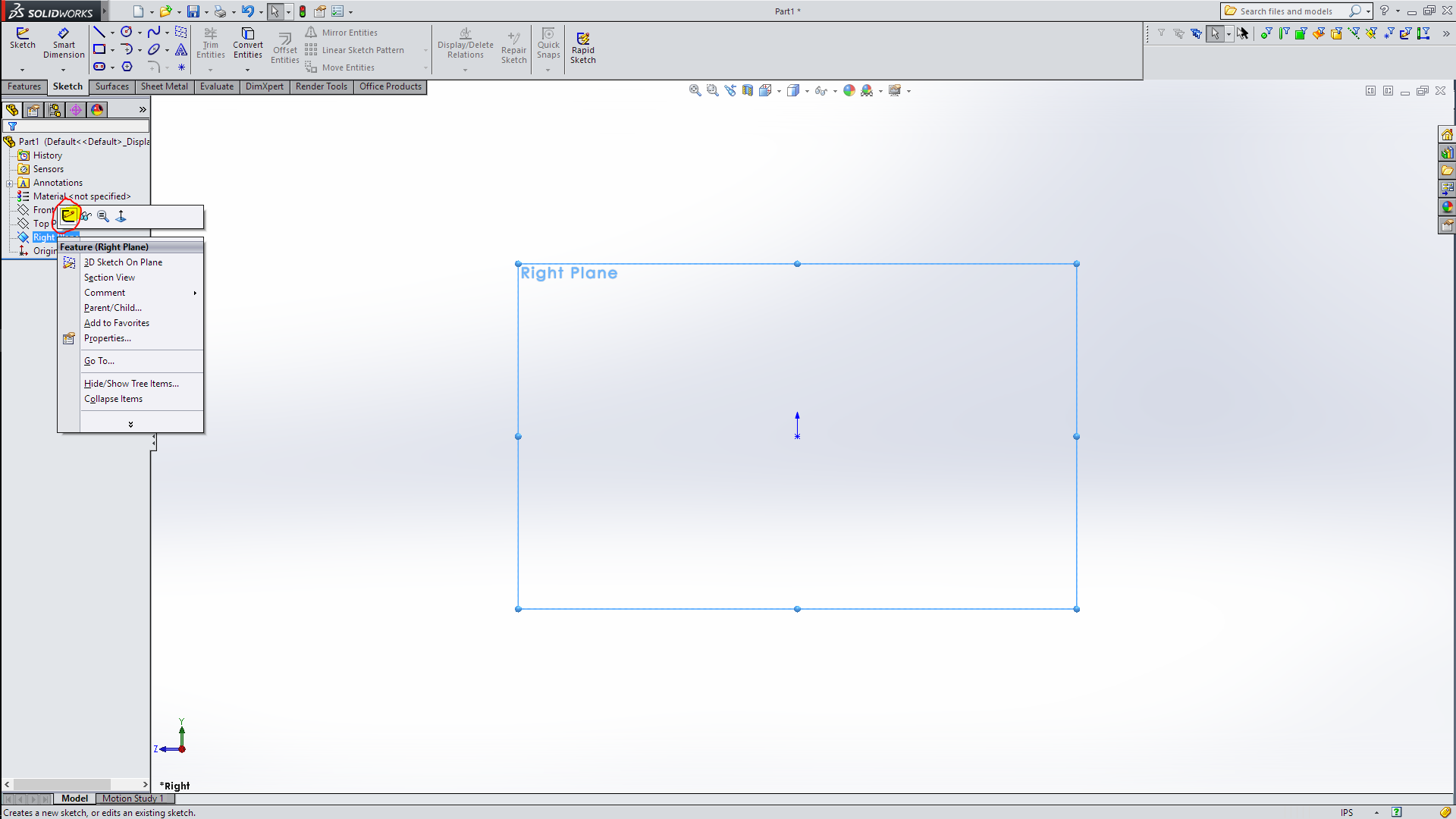

    in the feature manager tree on the left side, you will see 3 planes (top, side, and front) right-click on one of them and click on the pencil icon with the blue line (see the first screenshot attached).
  2. Step 2:

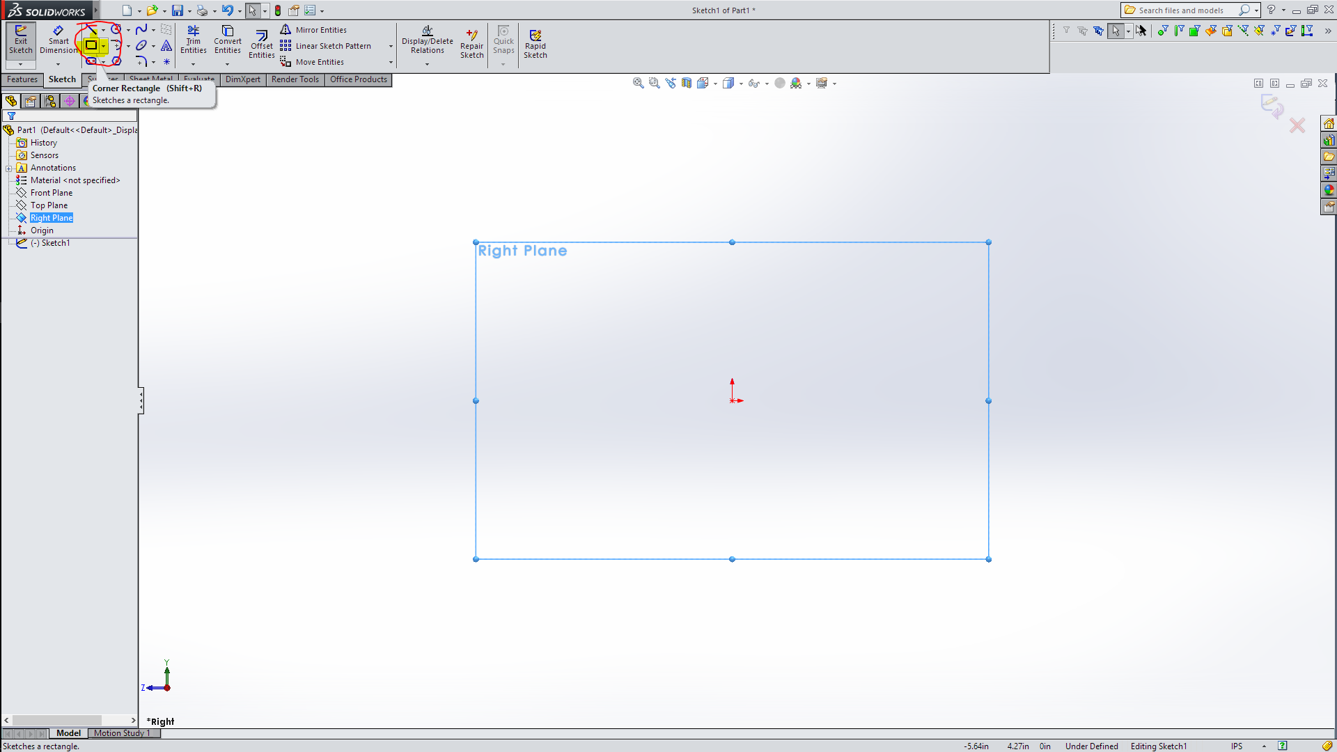

    Then click on the rectangle tool (second screenshot attached)
  3. Step 3:

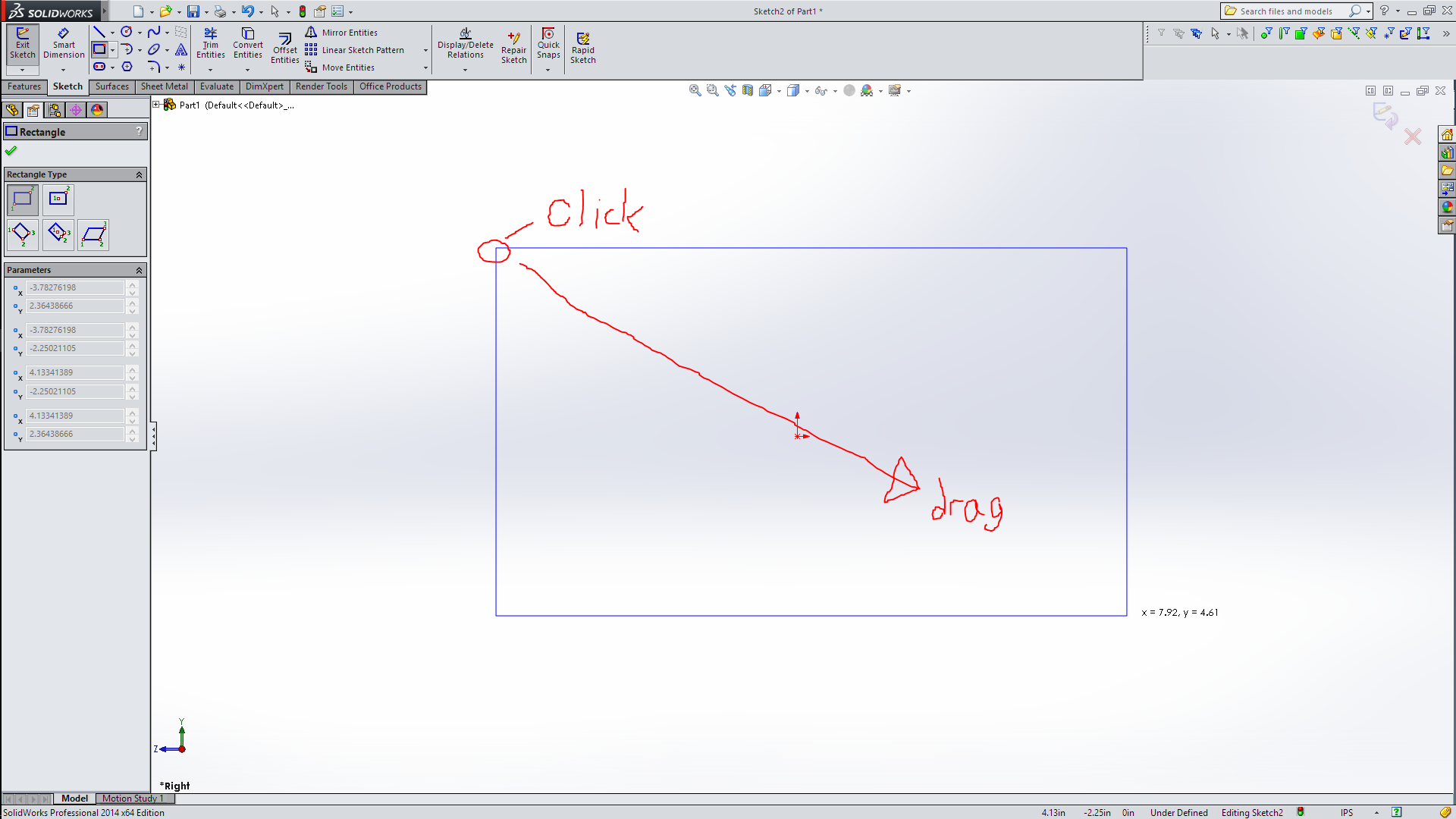

    Then in the main sketch area, click and drag to make a rectangle. (third screenshot attached)
  4. Step 4:
