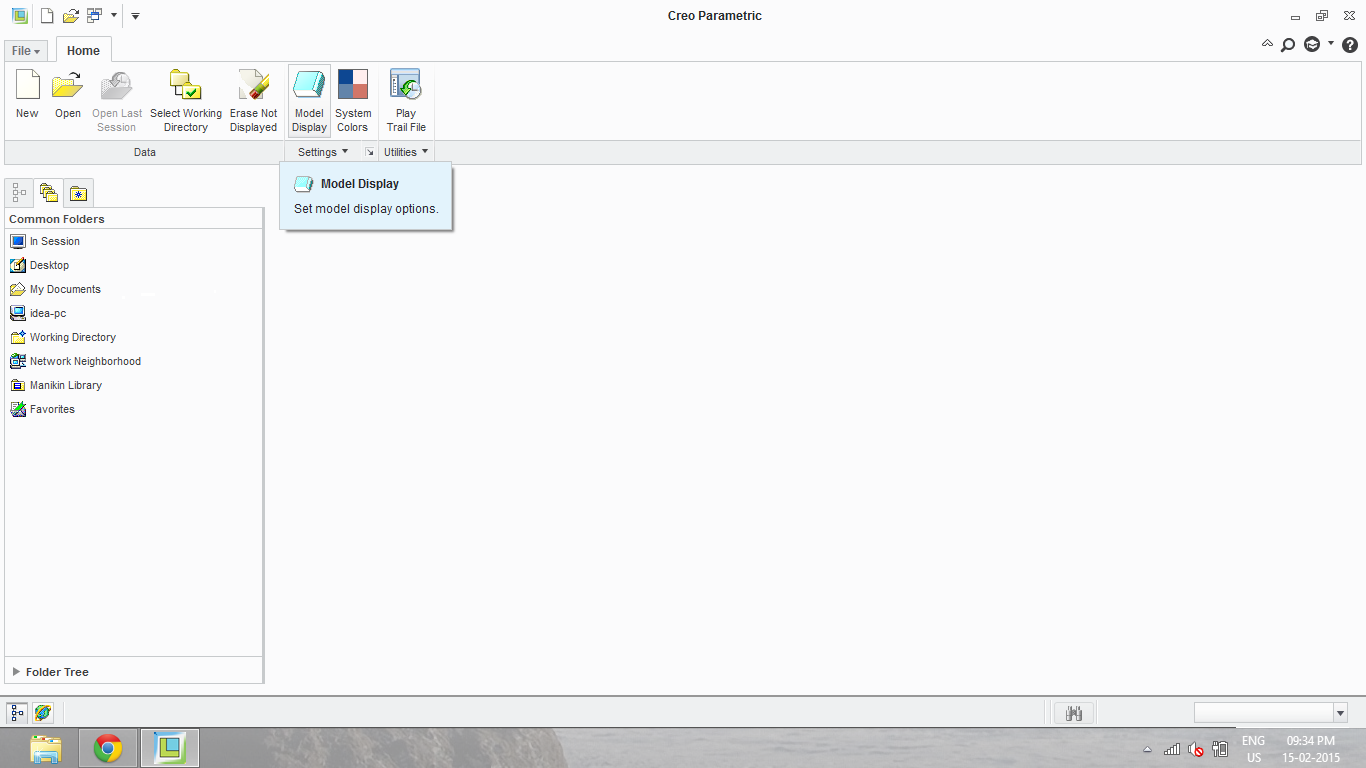

Step 1:
Step 1:
When you open creo go to Model Display settings
Step 2:
Step 2:
In model display settings select the sketcher option
Step 3:
Step 3:
Tick the Lock modified dimensions option in Dimension behavior while dragging the section
Step 4:
Step 4:
Press OK... If you want to save these settings permanently then press yes and if you want these settings only for this session than press no
